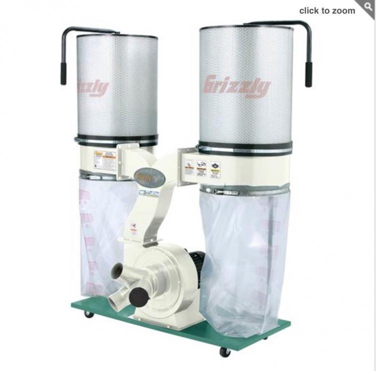

June 30, 201511 yr Author comment_61022 Well right now this is the one that I have chosen. It is the Grizzly G0562ZP, 3HP, 2300 CFM Dust Collector. It should be delivered to the shop sometime this afternoon. The best guesstament they would give me is between 12:00 and 5:00 pm. I am going to have to do some temporary re-wiring to get it running and then we are going to redo the wiring to the shop all together. This one is a 240 12amp unit where my older Delta was a 110v 15amp. I'll let you all know how well it goes in and how much difference it makes on the dust collecting. Report

June 30, 201511 yr comment_61031 Well right now this is the one that I have chosen. It is the Grizzly G0562ZP, 3HP, 2300 CFM Dust Collector. It should be delivered to the shop sometime this afternoon. The best guesstament they would give me is between 12:00 and 5:00 pm. I am going to have to do some temporary re-wiring to get it running and then we are going to redo the wiring to the shop all together. This one is a 240 12amp unit where my older Delta was a 110v 15amp. I'll let you all know how well it goes in and how much difference it makes on the dust collecting. Grizzly DC.jpg Looks like a good one. The price is certainly reasonable and the cartridge filters are seemingly the way to go. We'll be awaiting a review. Report

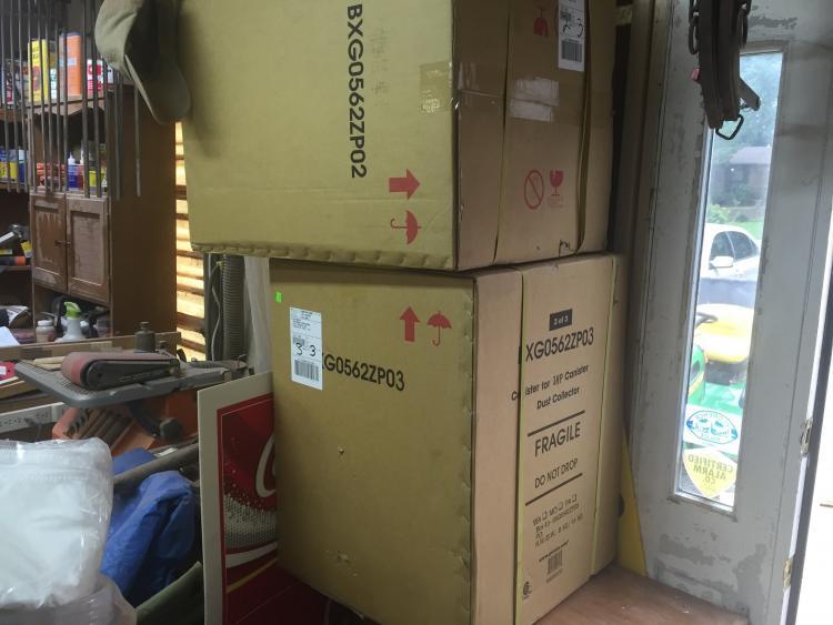

July 2, 201511 yr Author comment_61059 The new Grizzly DC has arrived at the shop. I will be doing a bit of re-wiring this weekend to get things ready for it. I have got to bump up the juice feeding the shop so I can add a couple more 220 circuits. Three good size boxes to get unpacked. I will be running new wire to the shop from the house and putting in a new panel in the shop. This should really take care of my future needs. Can't wait to get this new addition acquainted with the rest of the tool family in the shop. Report

November 28, 20196 yr comment_210536 I bet you was amazed at how they got all that stuff packed in that one box.... Report
