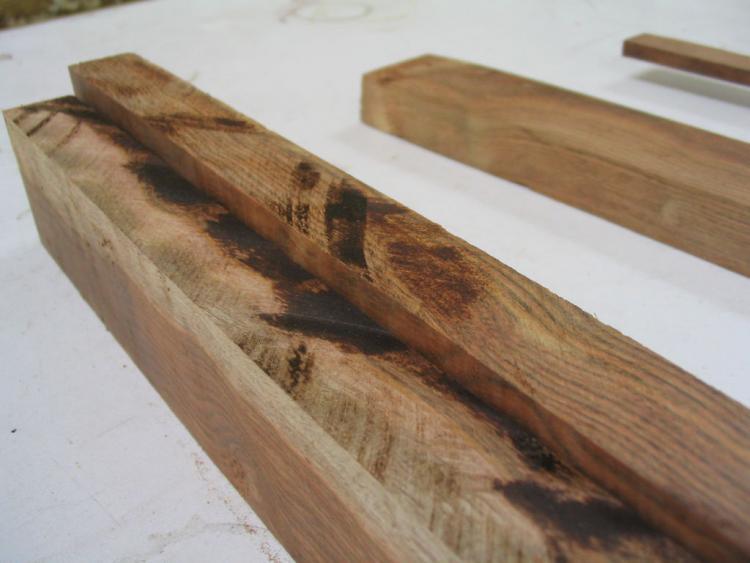

I'm wondering what kind of blades your talking about Fred. First read this and thought scroll saw. Seen the picture and thought table saw.
When a blade of mine leaves any kind of mark I clean, check and either get it sharpened or replaced.
If we're talking scroll saw, when I have to start pushing more and then, with the saw OFF, run my thumb over the teeth. If they don't hang up on my skin then they're trash.
OK, guys - bad picture but couldn't find a burned picture of scrolling - YIKES - why didn't I look in my trash pile ? ? ?  ?
