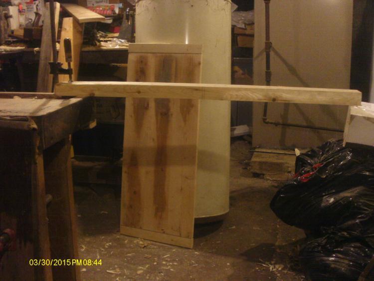

March 31, 201511 yr Author comment_59646 Well, got the top all planed flat, finally, and even fitted some ends to it Standing up back there against the old water heater. That 2x4? Became two of these four leg blanks. Have gotten some measurements for the sizes of the aprons. Haven't decided on where a drawer will go. There MAY be a bottom shelf, too. Will have to see what is in the budget... Legs needed a little jointing, so now have four blanks squared up. Report
