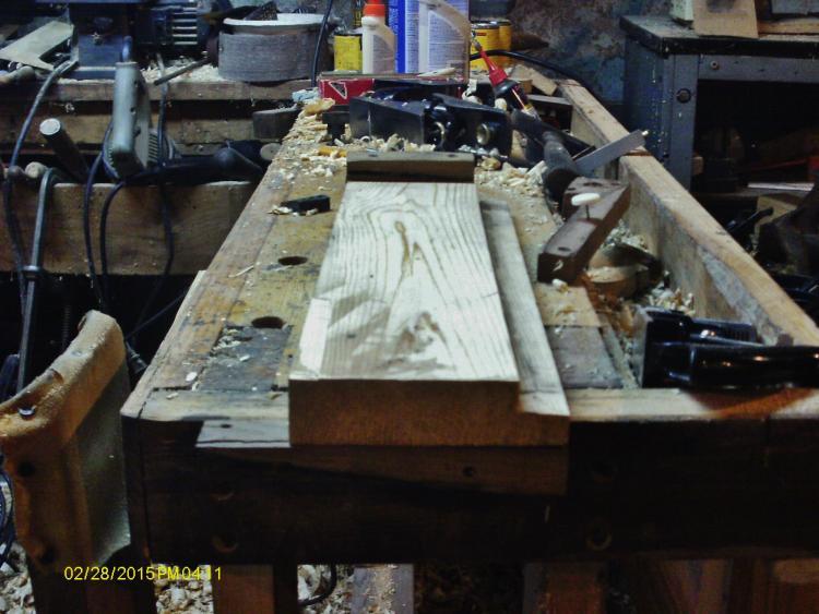

Well, I have a "chute-ing  Board"  to refine sawn edges with.    Made from a scrap of 2x6, and a couple hardwood cleats.    Wasn't quite set up right.  Took a jack plane to the flat area where the parts sit

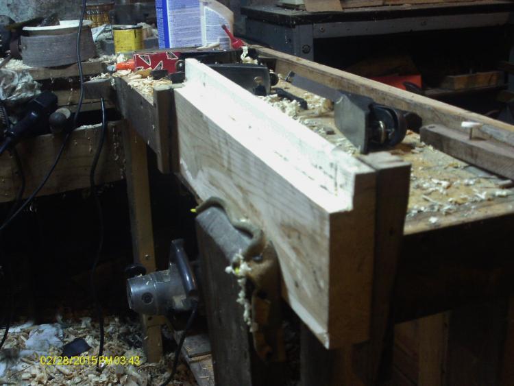

Then put the jig in the vise on edge.   Time for the Wards #78 rebate plane.   Had to remove the fence, and the depth stop.   Worked on both faces of the rebate, to get them at a 90 degree corner

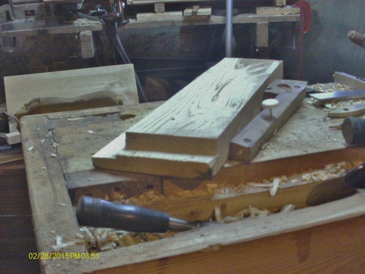

But the stop was getting in the way.  Took the screws out, and removed the stop.   It's rebate was a bit out of whack, too.   A Saw, a chisel and the 78 brought it back to square to the jig and almost flat

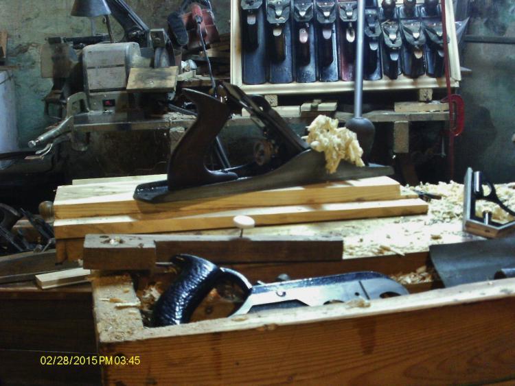

Re-installed the stop in the jig, a little "fine tuning" with a hammer.   Hmmm, sticks out into the track.   Grinder made that go away.  Time to try things out?

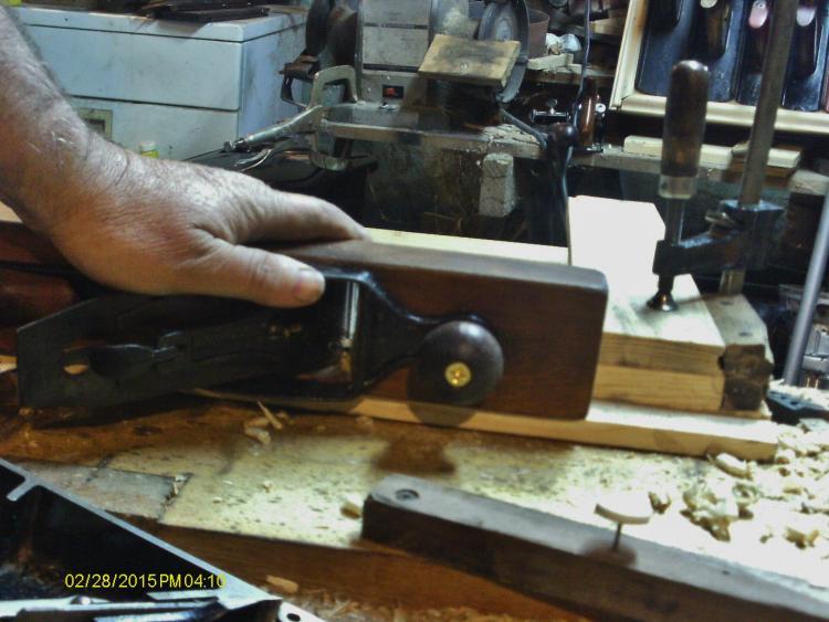

A Sargent #3416 Trans. Jack and someone's ham-fisted hand.  Couple of c clamps to hold things in place.   Not too bad, just a simple little jig
Anyone can make one.  Just have to pay attention to a few angles..
