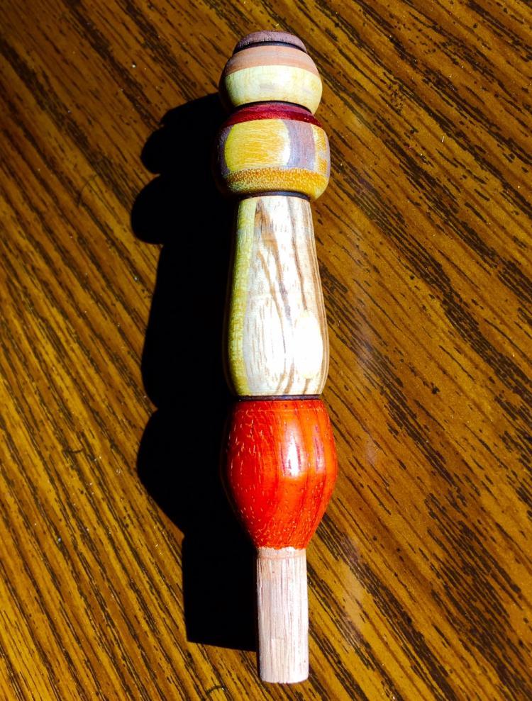

November 21, 201412 yr Author comment_56257 I really like these carbide tools. I am sure that most turning can be easily done with them. It is, as was said, a learning curve. Yesterday was a learning curve day and I am satisfied with my turnings. I really like these tools. The picture show a small ( 4" ) piece that I am going to make a crochet hook out of. I glued a bunch of left over pieces together and turned it part way down. It is far from the final project, but I like what I see. There are over 12 pieces in it, hard and semi hard wood, most are exotic. The tools worked very well and my final cuts were smooth as the old HSS tools Report
