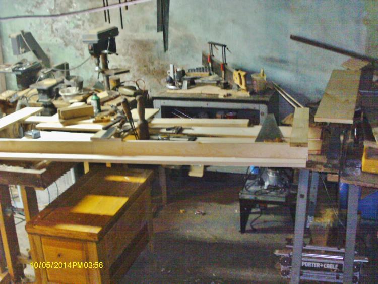

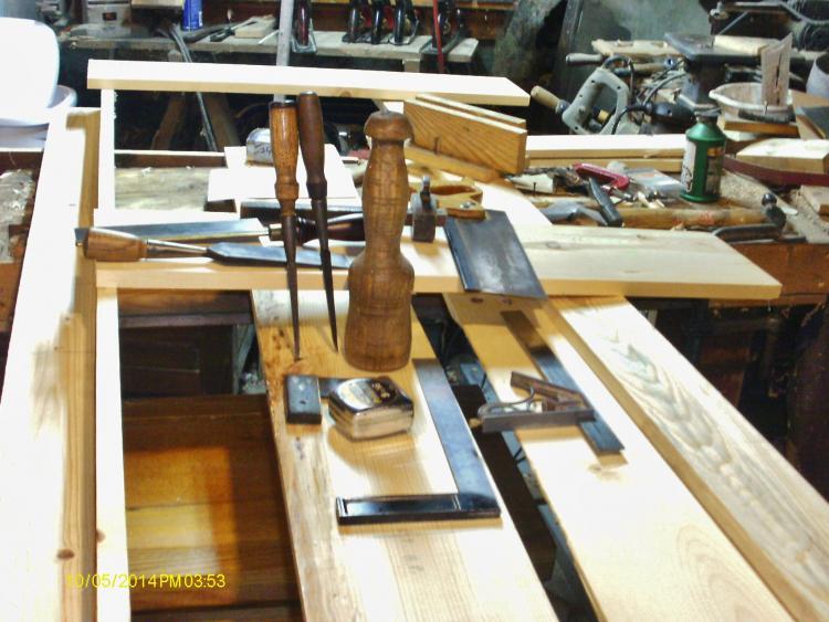

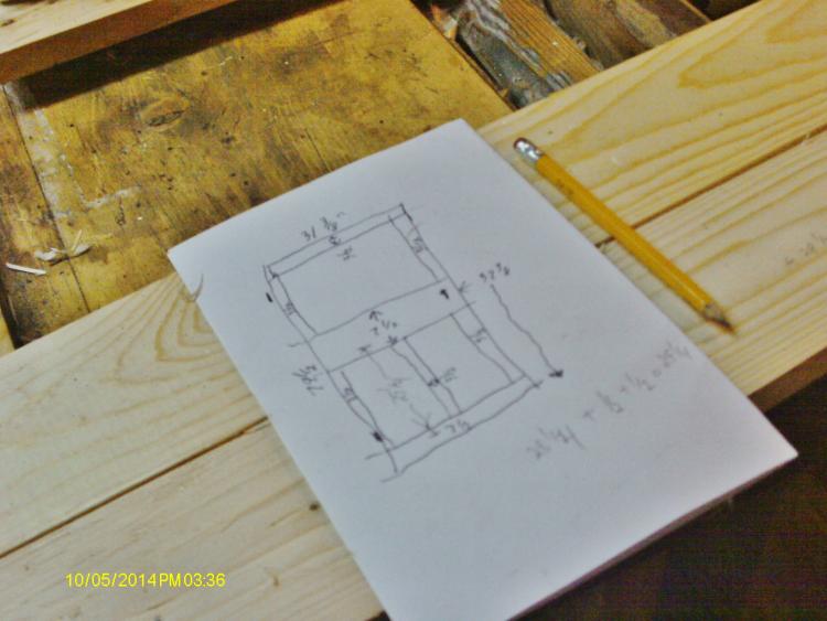

October 5, 201412 yr comment_55234 Well, at least the lumber is being cut, lines being drawn. The BOSS stated she wanted a new screen door for the back door, since that is the one everyone uses. The old metal "thing" is falling apart, just will not do. So, a trip to menards to pick out some Pine 1xs. Turns out the price was HALF of what Lowes wanted, for the same boards. Got a couple dowels, too. Started to layout some parts, it is a might crowded in the shop, right now Three steps from the bottom of the stairs, still time to turn back.. Well, someone scribbled SOMETHING on a piece of paper, might be something called a"Plan"? Eeeeh..could be. Laid out the 1x4s, well at least the straighter of the three I bought. Cut to 80" long. Marked and cut another for the top rail, marked and cut a 1x8 for the lock rail, and even a 1x 6 for the door sweep rail. Laid the parts out on the benches. BenchES because this takes up both of mine. I also dug out all the toys, er, TOOLS for the next few chores A couple small saws, some chisels for digging deep narrow holes, a few extra squares, and a small chisel beater. See anything that looks firmiliar? Layout lines are carried all the way around the 1x4 stiles. Will dig out the through mortises, and then make a groove for a raised panel, or two. Due to FleaBags in the house, everything below the lock rail will be solid wood. Will be a center stile to help hold two raised panels. Will also have to groove that stile on both sides, then Mortises and tenon joint to set it in place. Just a might crowded right now.. This may take awhile..... Report
