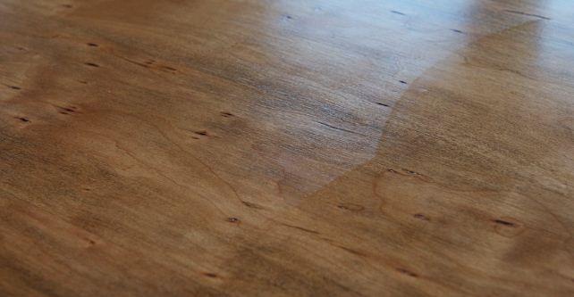

Have been working on a large trestle table, at he finishing stage, went with the wipe on poly described below by jim cull, great method, did numerous coats with gloss poly, last coats have been using semi gloss poly and finding that a pattern is showing up when I start the sweep and when I end, when it dries you can see when I have put more poly on my application cloth and when it ends, what can I do to fix this on my next coat. Did a 50/50 on the mix

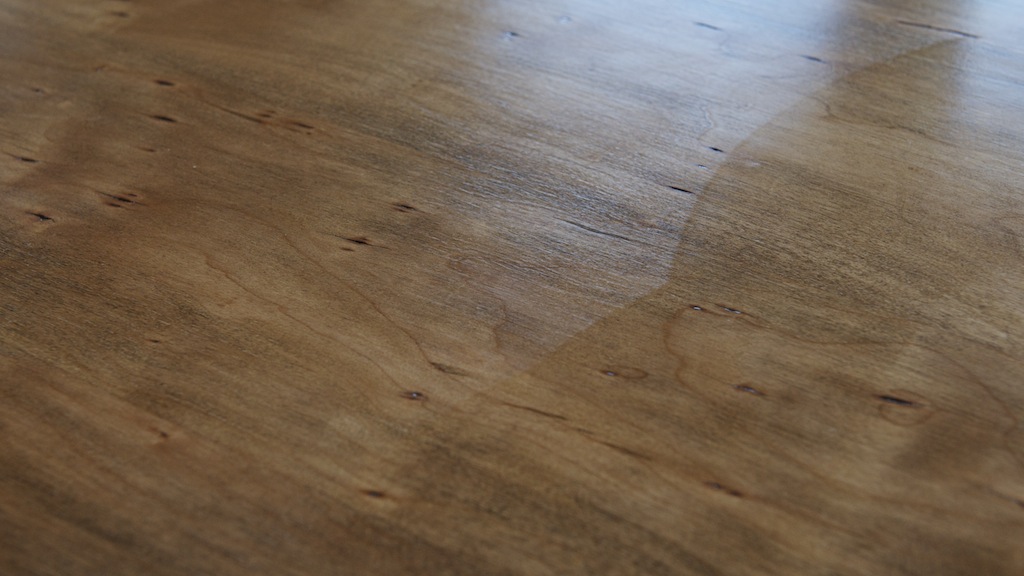

Hi Greg. I'm by no means a finishing expert. I usually just pass on information I get form others. First lets try to figure out what caused the problem. How many coats have you applied after you noticed the problem? My best guess is if your gloss coats went on well and you're application methods are the same with the semi-gloss my first guess is you're not keeping the flatting agents that are use in the semi-gloss well mixed.  Since poly doesn't melt into it's self like lacquer and shellac product I suspect you'll have to sand back to an undamaged layer.
Greg in the picture below, the section on the right is that the first coat of semi-gloss and is that the gloss on the left?
ning-table-51841-43.jpgIt will be important to keep the semi gloss stirred to keep well mixed. You will see some difference as you apply the coats, but they should level out as you cover the entire table. That is why I was asking if this was a shot after a complete covering of the table with the semi of just after a section.
I put 4 coats of gloss on with sanding in between the 3 and 4, then applied semi gloss, it started to appear then, so I thought it was early for any alarm so applied another, it continued and that is what you see here, this image is a completed second coat of semi. I sanded again with 320, wiped down, and just applied another semi, still not the best looking results I was expecting.... Just went out to shop to check the mix of the semi, it was not mixed all that well, lots of sediment came up from bottom, so will definitely keep that in mind down the road, could be the problem. Bigger one now is what to do to get the swirling wipes to match more, what is best approach to get things back on track?
ning-table-51840-66.jpgIt will be important to keep the semi gloss stirred to keep well mixed. You will see some difference as you apply the coats, but they should level out as you cover the entire table. That is why I was asking if this was a shot after a complete covering of the table with the semi of just after a section.
I think I see your problem.
NEVER WIPE ACROSS GRAIN.
OR IN A SWIRL PATTERN.
This doesn't allow the finish to be evenly applied.
Long straight wipes WITH the grain and don't wipe again.
by the way, I don't recommend using the gloss with the semi as they are 2 DIFFERENT finishes and I've never had much luck using both (always a problem).
And another interesting note, It doesn't have to have a thick coat to be protected, just the surface needs to be sealed.
I've have away used a windshield wiper motion when I've applied a wiping poly and it flows out nicely. That's one of the main advantages of thinning it so much. You can pretty  much slop it on and flows right out.  Anyway that's my experience.
I've also done satin over gloss and haven't  had problems as long as I constantly keep the satin poly stirred up good. If you don't it can streak on you. If you using the same brand of product the only different between the gloss and satin is the flatten agent which is a very fine power like "stuff" that act to break up the light transmission.
Rich

I was following jim kull's method of swirling action and don't go back, he mentioned nothing about with the grain. I think once the wood is sealed with early coats, I wouldn't think grain would be a factor
I agree with you richard on this, the only screw up is my lack of really mixing the semi well. On my earlier gloss coats it looked great, so the technique works with the 'swirling Denny's clean the table method' I am sanding again to take some of the heavier overcoats to bring them in line with the thinner ones which left ridges (as seen in the photo), will mix the semi again really well and get back at swirling another coat on, will keep you guys informed on the results later today, much appreciate all of your input, it sure helps.
greg
Excellent Greg! Please do keep us informed of your success. With pics if you can!Grin.gif
greg
