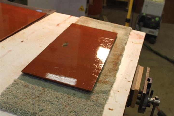

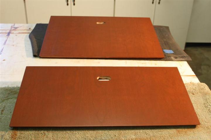

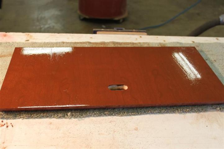

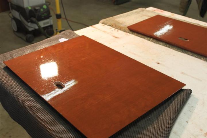

I'm making a couple dish washer fronts using a gel stain with wipe on poly (matching existing) for a kitchen I did back in 1989 because they have bought a new dish washer and the old front won't fit the new washer.
Here a couple pictures on how I apply the finish. The first three pictures you can see I just slop it on and left a very wet coat, that is not to say a real thick coat but very wet coat. The last picture is after the very wet coat has dried.
Hope this helps. Typically I put on 6-9 coats depending on use. I don't use much poly anymore because I spry most my finishes but when I do use poly this is how I do it.
