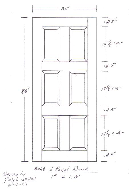

Hello Richard,
I don't know who you are directing your question but, as for myself I generally do about 35 to 40 doors per year and all in the old fashion methods. My mortises and tenons are all over 21/2" deep/long.
Here is a drawing of one of my doors that are good sellers.
ning-sixpanelstyledoortypical-51409-54.j
I make the most of them out of poplar if they are to be painted but mostly out of rift sawn red oak if they are to be finished with a stain and varnish.
Ralph
Ralph , that is a nice looking door ! To answer Richards question , about 100 per year give or take .For me building better and smarter is a mantra I work on around the clock . I've got some parts at the machine shop that will take my mortising a step further and we will see how it goes .Otherwise I will keep looking for an older dedicated machine as the next step .
