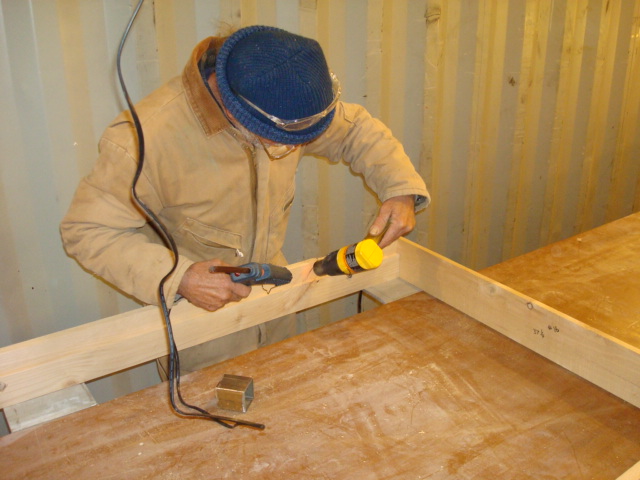

All the above - good advise.Some times I polish out the knots to a high finish , sometimes I carve away the surrounding material and leave the knot protruding for effect . Garniga Knot Filler is a neat little system that will fill a knot in just a few seconds and is really slick. I am just finishing a knot filling job that has lasted almost 8 weeks ( see my blog on flooring blank preparation )ning-knotfiller2-48943-54.jpg

Looks like tinted hot melt glue sticks - yes .The physical properties of the material itself are quite different though . No finishing issues. It is really fast -literally a few seconds .

Thanks man...already sent them my e-mail...wonder if I can just buy the sticks only, and use a standard glue gun? I'm sure they though of that and are using an oversize stick or something so you have to buy the gun too?
I see your using a heat gun to help it in those cracks, so it must set-up fast?
rob durfos said:
I own two of their systems and find the gun supplied to be high quality. The heat gun is is used in winter months when shop temps are near freezing. Set up time is 1 second pressed with a cold steel block .ning-knotfiller1-48936-74.jpg
