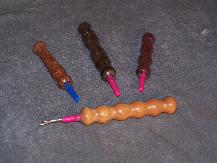

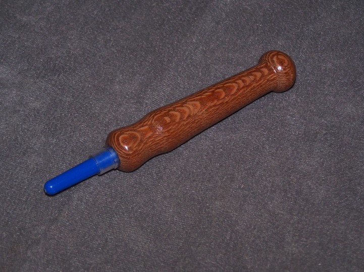

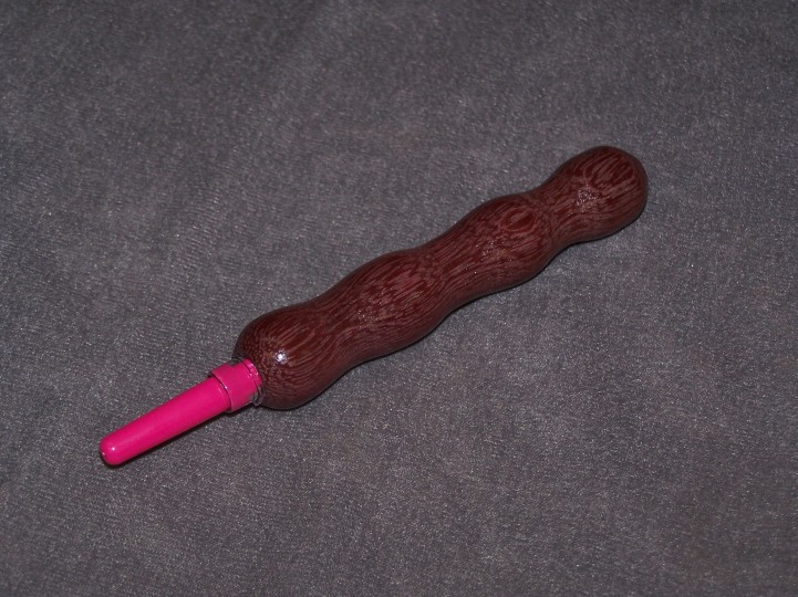

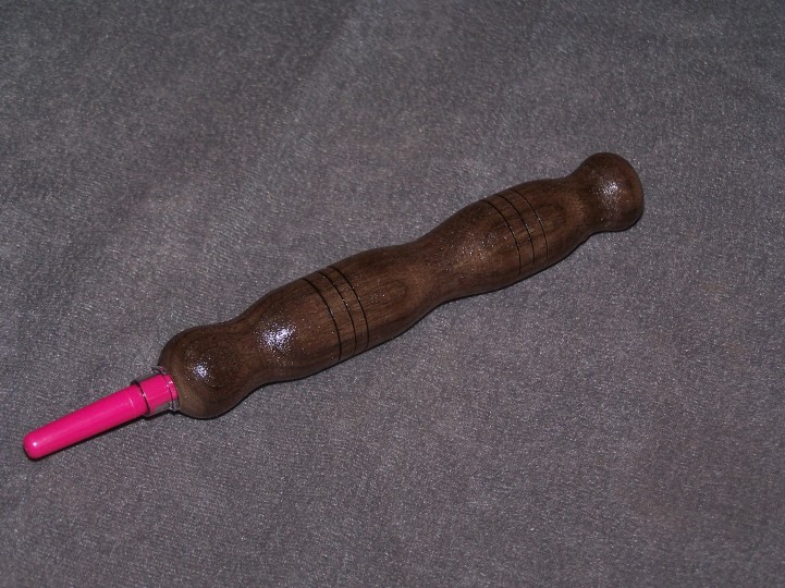

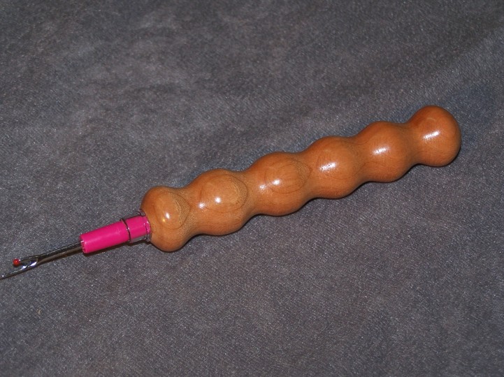

Well I know I am a little late with my review, but I have had too many projects in the shop.
Anyway, I got a chance to turn a few seam rippers this weekend and felt it would be a good test for me on the new General Finishes Turners Finish.
I applied to finish to the blanks with a paper towel much like I would any other friction finish. It went on very smooth. It seems as though it takes a few minutes for it to dry to apply another coats so I got out my heat gun and on a low setting put just enough on it to help the drying process without heating the wood. It allowed me to apply several coats in a shorter time.
I like the finish very much and will keep it in my supply of finishes to use.
