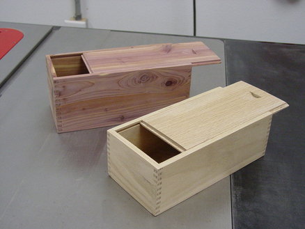

SQ,
When I saw these on another forum, I thought of you.
Gene
Gene,
Thanks for the picture.  Those are good looking boxes..  A sliding lid is a good idea, too.  Thanks for posting this.
SQ
