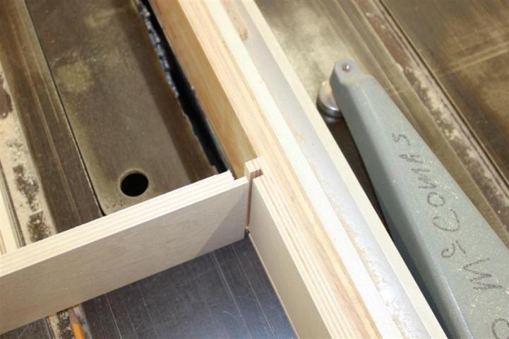

December 5, 201114 yr comment_37028 Lots of good suggestions so far. Another good joint for boxes is the locking rabbit joint. Very similar to the one Lewis suggested. The difference is both piece can be ran flat on the table if you find it intimidating to stand a box side on end. Report

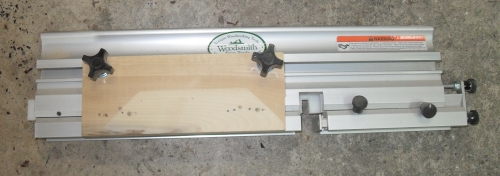

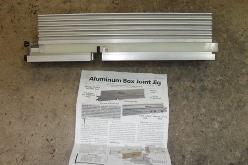

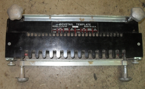

December 5, 201114 yr Author comment_37027 John, Your information was clear and concise - thank you!  The butt joint sounds simple enough but apparently they are not that strong.  The doweled joint has more strength and looks good.  Using screws instead of the dowels and using a plug seems easy enough.  I'm confident I can master any of those.  We have a box jig made from Woodsmith and a dove tail jig.  Pictures attached.  I am aware that the box jig is used on the table saw, and the dove tail is used with a router.  All I can find on the Woodsmith box jig is kit # 4502 658.  I have never used a router.  I can use a table saw.   I'm thinking the box jig would be the easiest to learn I've not used the router.  A video on how to operate the jig would be a huge help.  SQ John Morris said: Sue, you can certainly butt joint the box ends together, for a box that is used as a table top item, a simple butt joint is sufficient. If your going to use the butt joint (simply gluing the corners together) you should smear a little glue on the end grain boards and let it dry for a few minutes until it forms a haze, then you can proceed to apply glue on both pieces and clamp. Pre-treating the end grain in this manner assures that when you go to the final glue up, the glue doesn't soak into the end grain and leave the joint dry. So yes, the simplest form of joinery, the butt joint, has a place, and for a simple box that sits on a table top this is sufficient. You can add a little more strength to that simple butt joint, after it is all glued up and set, you can drill small holes in the corners in order to insert some dowels in the holes, now you have a doweled joint, and when planed and sanded flush it looks wonderful. You can see in the photo of my chair, that doweled joinery has it's place. Doweled joinery is time tested and works very well. You can also screw your corners together, be sure to counter sink the screws deep enough that you can add wood plugs to cover the screws. Now you say you have a box joint jig, can you please take a picture of it post it here, or tell us what make and model it is and we just might have one ourselves. And I am thinking selfishly, this might make a great video for us to produce showing the use of the jig. Now for the bottom of the box, again a simple surface to surface glue up is sufficient. You could glue up a bottom panel right to the bottom of your sides, use a nice contrasting wood and I am assuming your using all solid wood for this. You know how to make nice lids obviously so this should be the funnest part for you! I am really interested in what jig you have in your possession, so lets see what you got. Let me know if any terminology I have spoke is foreign, and let me know if anything I have said is not clear. We can do this Sue! John MorrisThe Patriot Woodworker Report

December 5, 201114 yr comment_37020 I have always been a little box phobic myself but I tried the locking rabbet method mentioned above and my boxes came out well the first time. I don't know what your material is but hardwoods and good plywood and even MDF should work. All you need is a table saw, glue and some clamps: no fancy jigs needed.Bruce Report

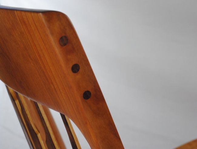

December 5, 201114 yr comment_37017 Back about 20 years ago when I made Cedar Hope Chests, I used my table saw with an adjustable carbide dado blade and used rabbit joints on the ends, then used #6x1 self tapping wood screws to hold them together along with a bead of wod glue. Then I would rip a piece of scrap cedar and use the plug cutter in the drill press and make matching plugs to cover the screw heads and then sand em down flush. Looks great too. I made over 200 sedar chests. I was doing them in an assembly line form. I would cut all the pieces to make a dozen ata time. Report
