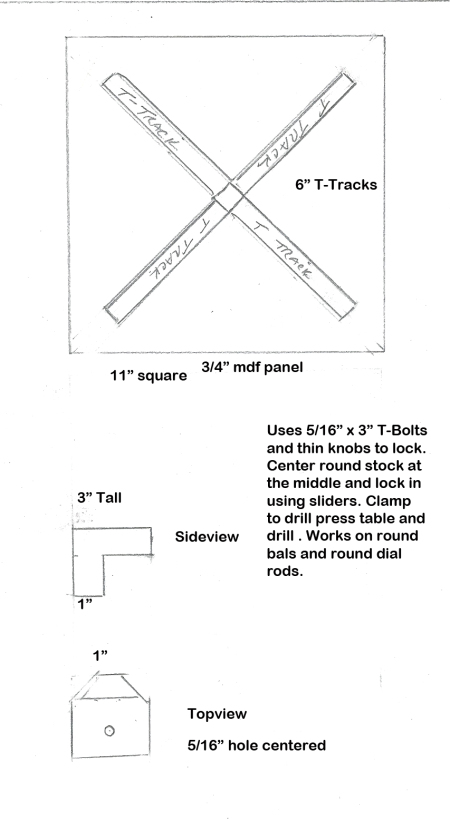

January 15, 201214 yr comment_35537 Sorry for the delay in getting this jig up. Been busy with a new job and had to draw out a set of plans since I lost the original. It is easy to make and small enough to store anywhere almost. The drawing is rough but you get the idea. The holders are of any hardwood you would have laying around, I made mine from maple. Any questions feel free to ask. Wayne MahlerGod bless and protect our troops that serve so we can be free. Report
