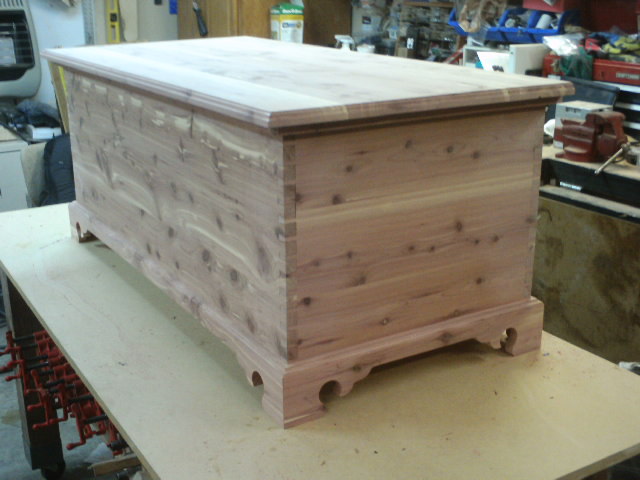

So I started this Cedar Chest about a month ago.

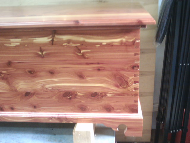

Dovetail joints in the corners.

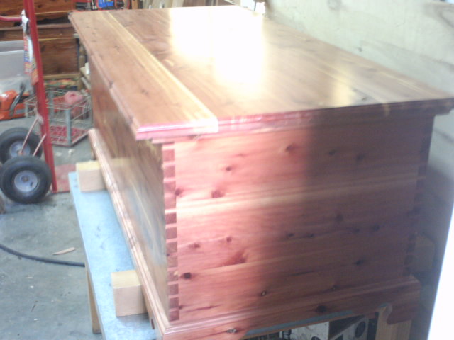

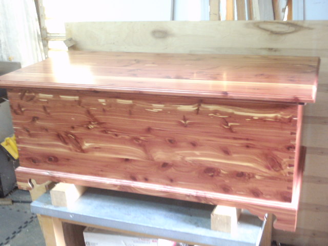

I got the final coat of varnish on the cedar chest on Thursday night. Saturday morning, I got the hinges back on the lid and the lid on the chest. Here it is, three coats of Shellac and three coats of General Finish Enduro Var, Satin finish.

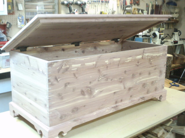

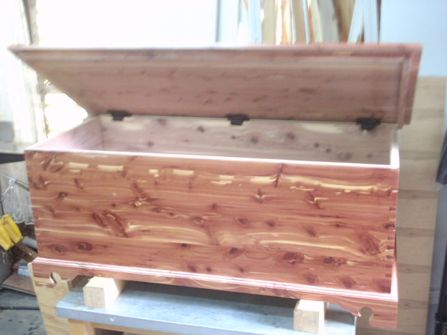

ning-imag0022-34329-25.jpgning-imag0023-34329-32.jpgHinges are Torsion Hinges from Rockler. It has two 60 lb and one 40 lb hing. They will hold the lid at any position you put it. Sorta like a laptop lid.

Very nice!! Really like the look of the cedar wood.

 Yep, that turned out really well. I like the way you did the base.
Beautiful chest John. What kind of dove tail jig do you use? I am shopping for a new one and have not decided which one to get. Too many choices!
    Bob
Robert I use this one. I purchased it a couple of years ago at The Woodworking Show. It works really great and it pretty easy to setup. Cut the pins on one side and the tails on the other side.

Really nice chest, John. The dovetails and the base treatments are very nice.
Just curious, why the different hinge weights?
Gene
I weighted the top once it was put together and then went on the Rockler site and they have a calculator that tells you which hinges and how many you need for the top based on the depth and weight. These hinges hold the top at any position you put it sorta like a laptop. It can be part of the way open or all the way and it will hold it in that position.

Great job!  I don't see the dimensions but it looks huge.  The base is very decorative and adds such a nice touch.  Now you have room for bowl making.  Grin.gif

Thanks Sue, I have one more on the bench and then to the bowl making. It is 46" long, 20" deep and 20" high. Pretty much standard blanket chest size.
