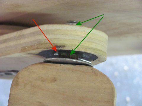

Solved the problem by actual bolting the peddle bolt to the peddle arm.  (See Picture).
Green arrows point to the two nuts that I put on the shaft of the carriage bolt.  The red arrow points to a drill-through hole in both the nut and bolt and attached a cotter pin.  The actual peddle pads rotate ok on the smooth portion of the carriage bolt thereby (in theory) not wallowing out the peddle.  Time will tell.
This seems to work for now.  gotta get on this thing and build up some leg and thigh muscles and to practice.
