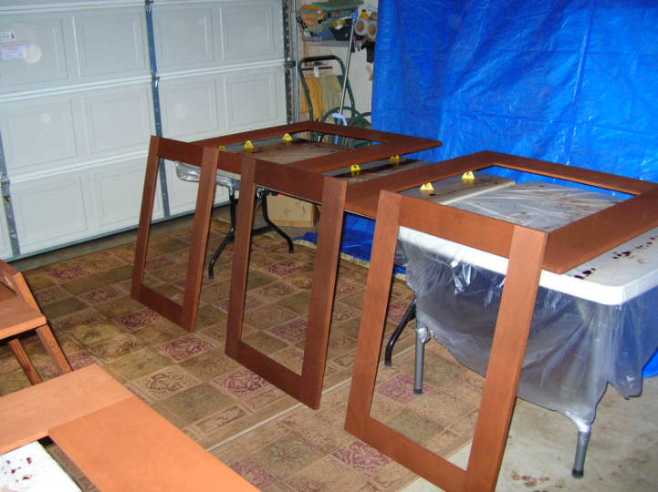

February 12, 201214 yr Author comment_34148 Allen those look really good. The finish looks great and so even. Looks like you got the dye figured out. You might have to write a blog on the experiences of using dye the first time.Good job. I know it wasn't the way you had planned, but life gives us those lane changes every now and then just to take us out of our comfort zone.John MoodyJohn Moody Woodworkshttp://www.johnmoodywoodworks.com Report

February 13, 201214 yr comment_34145 Allen, Very nice job. Â SQAllen Worsham said: I have been working on the 10 frames (5 large at 43"x43" and 5 smaller at 36"x26") for church made from 5/4 Beech. I should have had the 5 large frames completed and delivered on Friday, but the Beech did not like the stain that I was using and was really blotchy. So I had to sand down the 5 large frames to bare wood and start over from scratch using dye. It took me 2 days to get them sanded down as well as wiping all 10Â frames down with water to raise the grain and then giving them a final 220 grit sand to get ready for dying. The dye worked well and was a bit of a learning curve as this was the first time I have used dye.The color evened out pretty well and is a bit different than the original stain, but they should look ok. I only had to make up 1 gallon worth of the dye as that beech soaked it up like a sponge. So hopefully tomorrow I will be able to start spraying a seal coat of blonde shellac (since the dye is water borne) before spraying a few coats of satin polycrylic for the top coat. Here are some of the frames. The frames look like they are 2 different shades, but that is just the lighting. Allen WorshamCorona, CAallenworsham@earthlink.nethttp://www.awcreationsandwoodcrafts.com'Graze in every man's field, but always give your own milk' J. Vernon McGee Report
