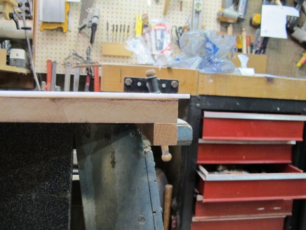

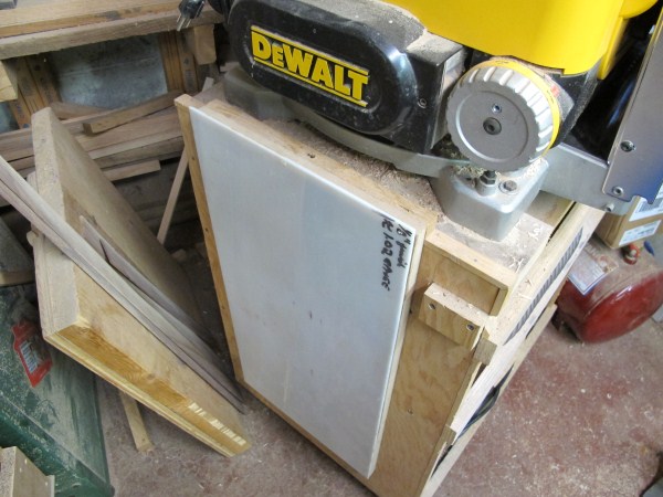

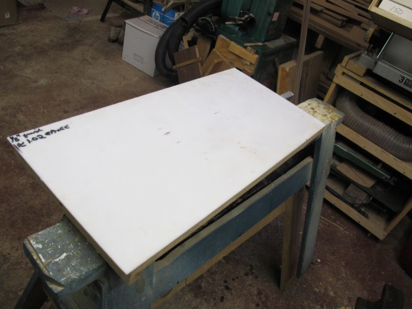

February 12, 201214 yr Author comment_34102 Lewis, Thanks for the pictures.  I really didn't understand it was stationary and that it had a lip.  You have been a huge help.  Will be planing more wood very soon to 1/8th inch and feel confident these ideas are going to make it possible. SQLewis Kauffman said: Here are some pix The "lip" shown at the rite edge of the piece hooks over the planer extension table to lock the "sled" into place. This sled does not pass thru the planer. It has the effect of raising the planer bed. The stock is pulled thru, sliding on the plexiglass.  Used this process instead of double sided sticky tape because of the volume of pieces I need to plane when making rolling pins.  Here is a pix of a piece I was playing with when the drum sander project was completed. Can's do this with my planer! SQ said: Happiness is wood chips flying! Report
February 12, 201214 yr comment_34101 Glad they helped you with some ideas. When the stock gets down to about 3/16", pay particular attention to any gouges or tear outs that might occur. This is usually where things come apart. Also, any "wild" grain patterns can cause the pieces to separate/shatter and knots are a big NOT!SQ said:Lewis,Thanks for the pictures.  I really didn't understand it was stationary and that it had a lip.  You have been a huge help.  Will be planing more wood very soon to 1/8th inch and feel confident these ideas are going to make it possible. SQLewis Kauffman said:Lew-Time traveler. Purveyor of the world's finest custom rolling pins! Report

February 17, 201214 yr comment_34099 On My Hammer JP, I plane to 1/8" with success by doing the following:I lock the anti-kickback fingers out of the way with some blue tape and a little wedge piece of wood I tape in to keep them from falling back down- Gotta take off the shroud to do this.then I use a riser platform which is just a piece of 3/4" sheet-stock cut to width and longer than the table with a little cleat on one end to keep it from feeding through. Occasionally the wood shatters but not usually. I think it depends on the lumber.I haven't gone thinner than 1/8" but I prolly could go a tad thinner.I made the plywood riser slippery with a coat of Enduro Pre Cat 181 and waxWhen Planing I don't have my hands of face in the area of the in-feed or out-feed against the possibility of something going wrong and splinters flying Report
