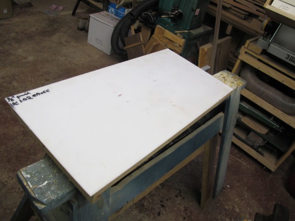

I'll take a pix of it today and post it here. I did make it, yes. It's just a piece of stock (plywood, I think) and I had a piece of plexi the same size. Glued it on with contact cement. I hangs on the side of the planer cart.

Here are some pix
The "lip" shown at the rite edge of the piece hooks over the planer extension table to lock the "sled" into place. This sled does not pass thru the planer. It has the effect of raising the planer bed. The stock is pulled thru, sliding on the plexiglass.  Used this process instead of double sided sticky tape because of the volume of pieces I need to plane when making rolling pins.
