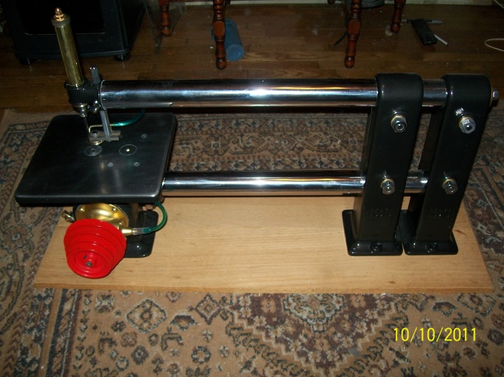

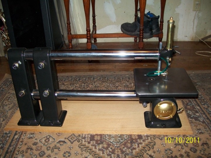

Here's a couple of pictures of the 700 Scroll Saw.  There is a write up about it's Resto-Mod here on TPW in the Old Woodworking Machines Forum. It is a combination of what were basically two parts machines.

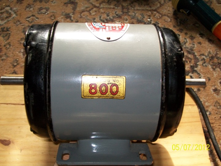

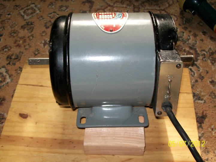

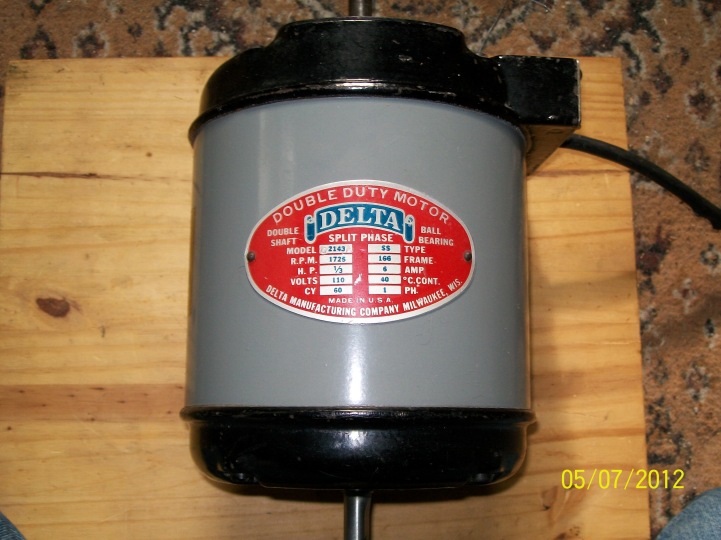

This is the motor that I will be using for the trio combo. It was a buy it now on ebay for $25.00!!!

Thanks for the compliment on the scroll saw. The motor is all original, all I had to do to it was repair the centrifugal switch in the start circuit.

On the 700 the plunger tube is brass that was not plated, so all I did was give it a good buffing.
I reworked the plunger tube assembly so that I could use the upper steel blade chuck from a model 1200 scroll saw.

The 700 did not have the indexing feature on the tube that the later model 1200, 1440 etc. did. The 700 had the indexing feature located by a pin on the upper blade chuck that fit into holes in the head casting. The upper plunger shaft on the 700 was round vs the square shaft used on the later model saws. On the 700 the upper plunger gets assembled into the head casting, the later model saws had it assembled as a cartridge that fit into the head casting.
The weak link on the model 700 scroll saw was the fact that the blade chucks were cast Zamak, and would break if the screw to hold the blade was over tightened.Frown.gif I ran accross several 700 saws where the upper blade chuck was broken.
That is why I ended up having to modify parts from the later model 1200 to work with the head casting on my 700. It now has the later steel blade chucks that were common on the 1200 and later models. The lower chuck that I used is from a model 1440 ( 40-440 ) series scroll saw.
Here is the link to my 700 rebuild where you can see what I did to use the later model parts.
http://www.thepatriotwoodworker.com/forum/topics/delta-700-scroll-saw-restoration-and-upgrade
Adapting the later model parts to the model 700 also gave me the benefit of being able to use the self centering chucks that Delta offered for the model 1200 and up scroll saws.

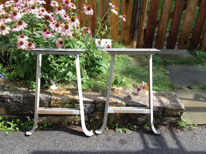

They were in most of the catalogs from the late 20's through 40's, but here is a picture of a set.
ning-photo-33220-31.jpg?width=721This set sold in my price range, but I was late to the party and missed out.Frown.gif...106.gif
 39.gif I could probably make a set using the legs from a scroll saw stand.
