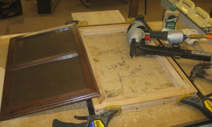

May 26, 201214 yr comment_32032 Jig to clmap in & hold down framing for my double certificate frames. Report

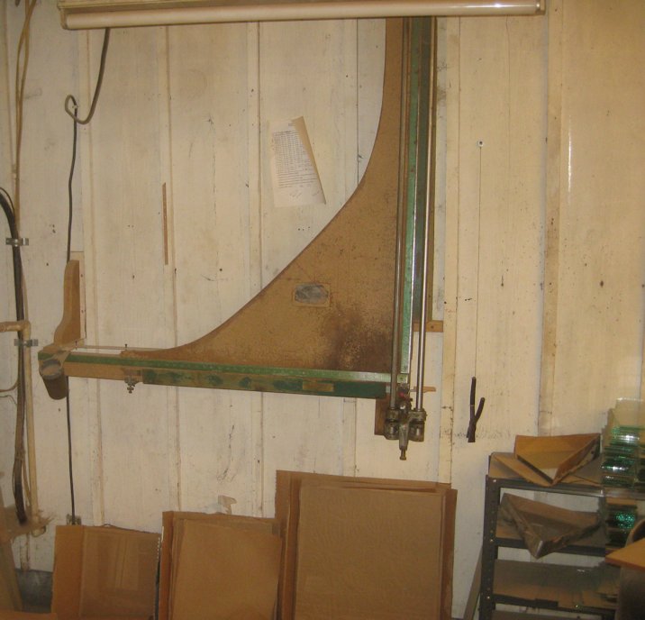

May 26, 201214 yr comment_32031 Glass Cutter and Jig attachment to cut my angled glass for displays. this model is Fletcher glass cutter 1964 model one of the first they built and came out of their factory.. still working strong.. Report

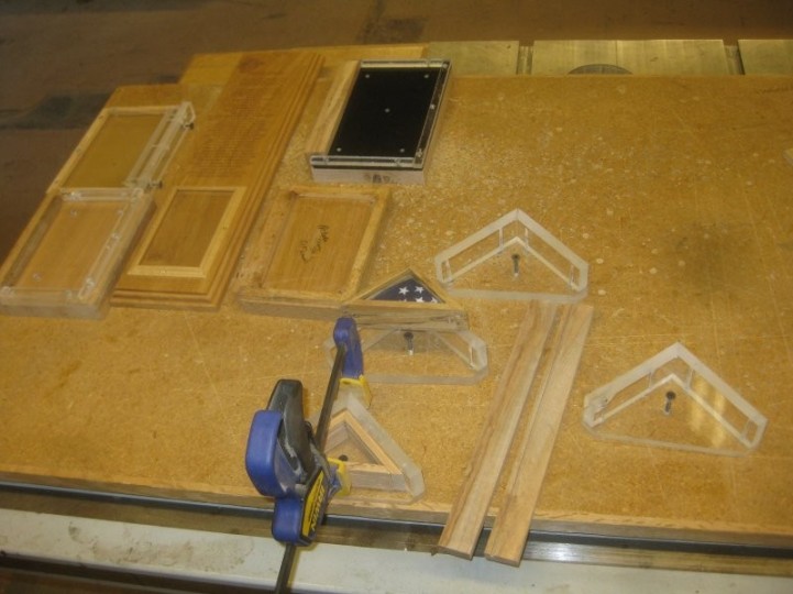

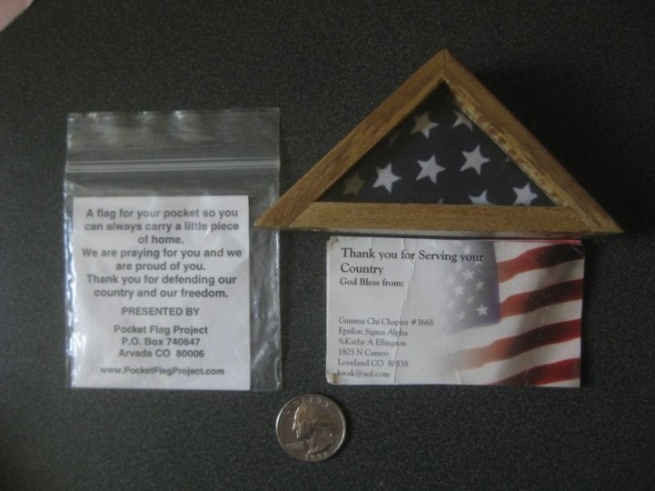

May 28, 201214 yr comment_32030 Jigs on the top left are for miniture picture frames I build. 3" X 5" 4"x6"Â and the lower jigs I built to mass produce (glue up) my miniture flag cases. these hold the soldiers pocket flags. Report
May 28, 201214 yr comment_32029 Like those little pocket flag jigs! Neat idea needing only one clamp!Lew Kauffman-Wood Turners Forum HostTime traveler. Purveyor of the world's finest custom rolling pins! Report
May 28, 201214 yr comment_32028 Thanks Lew, Yes and while they are still clamped I drill and countersink and add #4 stanless screw in the bottomsI use allot of my cut off (scrap) material to build these lil things and once they are all put together they are quick to sand/finish out the little picture frame jigs are quick and easy also.. just tighten up the screws that press the glued frames all togther and an hour later I can remove and add another frame Lewis Kauffman said:Like those little pocket flag jigs! Neat idea needing only one clamp!Lew Kauffman-Wood Turners Forum HostTime traveler. Purveyor of the world's finest custom rolling pins! Report
