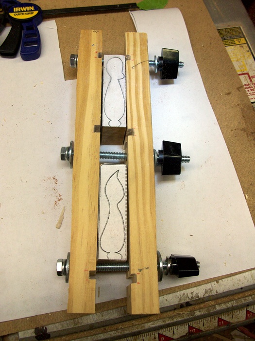

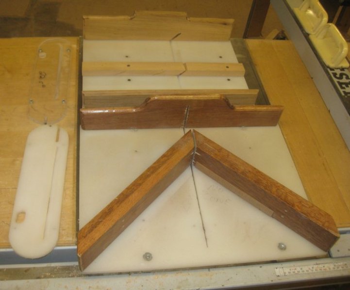

this is the one I use the most for compound cuts on the scroll saw. I've got a couple smaller ones like this for cutting some of the real small stuff. I need to make a planer sled, it would surely come in handy.
Greg
Scroll Saw forum host

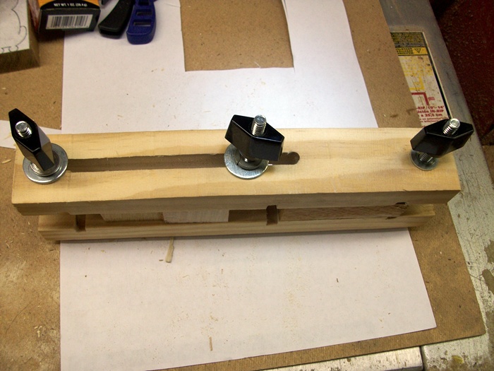

I make them as I need them. The one I kept and use the most is a box joint jig, that is fully adjustable and easy to use. The others, usually end up in the scrap box or dismantled for another project or jig.
Wayne Mahler

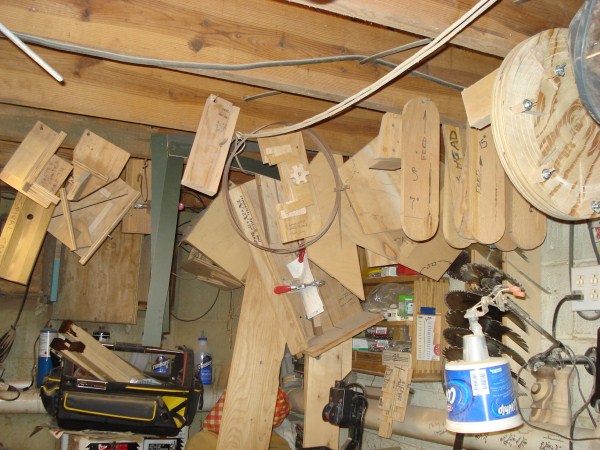

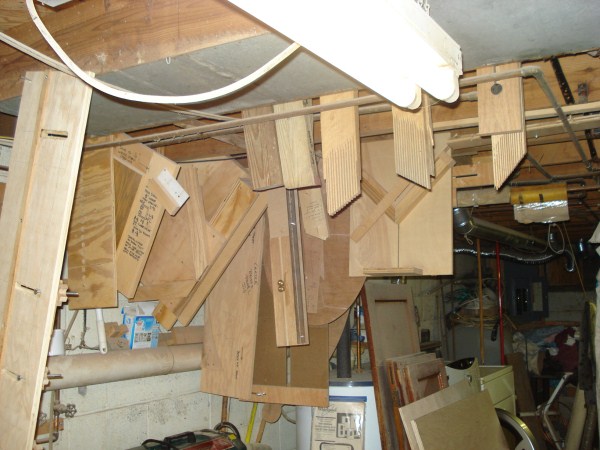

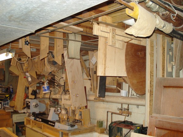

Jigs, do I have Jigs!?!
Panel cutter hangs on table saw
Circle cutter and resaw jig hang on the band saw
Usually label them with specific setup information and so I can remember what they were used for. I like the idea of attaching a photo to them as a reference.
Lew Kauffman-
Wood Turners Forum Host

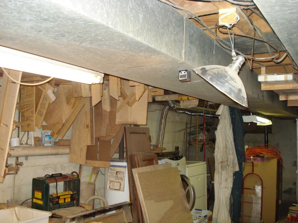

I emptied the cyclone collector the other day and found a bunch more smaller ones- hiding behind it- that were for one time projects!
Gene Howe said:
WOW, Lewis. That's a bunch of jigs.
Gene

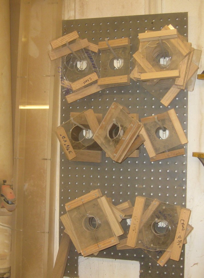

I will have to revisit this topic as I build all my jigs for my work in the shop... many I use over and over
especially my tablesaw cross cut miter jigs.. others that I build I always lable them for sizes and used on?
I'll have to take and post photos to this topic.
most all my jigs I build from scrapped out Plexyglass from a local company that works with 4X8 sheets of this stuff and they toss out what they cannot use any longer... these work great!!

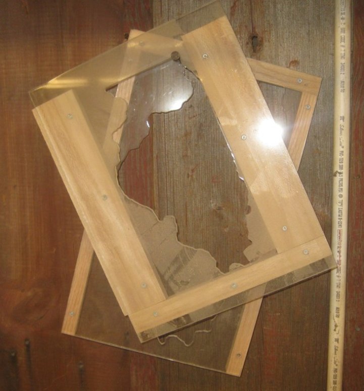

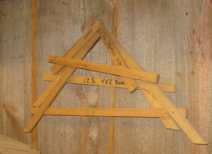

This is one of my main Jigs for building my certificate frames in Mass... It's built from Hard Maple Base, 3/8" Plexiglass with Ash Shoulders. the lockdowns produce 700 Lbs torque/locking power. certificate frames are 8 1/2" X 11" standard inside measurements. I can also add additional blocks to build 8X10 and 5X7 frames in mass.
ning-download-32038-10.jpgEdited by me to show image in thread (Charles)
