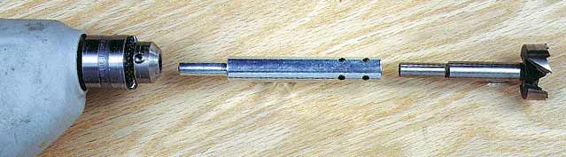

May 11, 201214 yr comment_29828 OK guys and ladies, I am in a bit of a dilemma here. For several days now I have been looking for some drill bits. the major requirement is that the bits must contain 1 drill bit that is 1" wide for wood boring and at least 6" long USABLE, so that I can drill a hole in a 4" long piece of wood and not lose the bit in it or snap it off or whatever. I want to make a pepper grinder but need a long shank bit to get it done. Can someone please point me in the right direction, i have seen a lot of drill bits over the last several days, but they are either too short, too long or don't even mention the length as if that isn't part of the specification Thanks for the help. Charles NichollsSite Hostnicholls61@att.nethttp://www.nichollswoodworks.comThis website is new so it doesn't have much to it yet but you are welcome to take a look Report
May 11, 201214 yr comment_29857 A forstner bit would be best and you will probable need to purchase an extension for the bit to give you the depth you need.John MoodySite AdministratorJohn Moody Woodworkshttp://www.johnmoodywoodworks.com Report

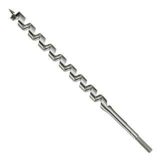

May 11, 201214 yr comment_29851 2 ways I know of:  http://www.mlcswoodworking.com/shopsite_sc/store/html/smarthtml/pag...   Scroll down to bottom of page. This has a 4 sided extension that will hold the bit square (squarer) than one that only has 2 hex screws.  The other way is to take one of these http://www.irwin.com/tools/drill-bits/power-drill-long-ship-auger-bits   and use a big 3/4 inch d handle drill or a drill press but it's kind of tricky so get ahold of me if you got any questions.     Report

May 11, 201214 yr comment_29849 Dragon, I'm a long time customer of MLCS and have never stumbled on to that extension. Many thanks for the link!!! I have an 18" 2 screw extension that, I'm assuming, is intended for electricians. I cannot recall ever needing that much length. And, it will not accept my Forstner bit shanks. Again, thanks a bunch.dragon1 said: 2 ways I know of:  http://www.mlcswoodworking.com/shopsite_sc/store/html/smarthtml/pag...   Scroll down to bottom of page. This has a 4 sided extension that will hold the bit square (squarer) than one that only has 2 hex screws.  The other way is to take one of these http://www.irwin.com/tools/drill-bits/power-drill-long-ship-auger-bits   and use a big 3/4 inch d handle drill or a drill press but it's kind of tricky so get ahold of me if you got any questions.     Report

May 11, 201214 yr comment_29847 Just another resource, Woodcraft also has a pretty good inventory of Forstner Bit extensions. Â Forster Bit Extensions Support Woodcraft, they support us!!! John Morris The Patriot Woodworker Proud Supporter of Wounded Warrior Project and Homes For Our Troops Report
