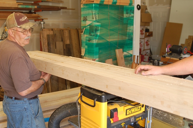

June 10, 201214 yr comment_28985 Well guys the second glue up went well today I have a few photos in the can and will try to re size them and post them tonight. I do hope that some of you are reading this thread and that you can see why I do the things the way I do. I want you to know that after the glue up of the second top on bench one we planed the top on bench top one of the bench one set. I am pleased there are no gaps and the glue lines are non existent. I am so very happy that I have a perfect top and it is to die for . I think we were really stressing the little DeWalt 13 inch Planer to its limits but the job went really well The only big issue is the planer sits on top of my workmate 200 and with the 8 foot long 125 pound top the little plane got a little tippy I will be looking for a more stable weighted base that I can bolt the plane to so it doesn't t get tippy. the top was simply too big for me to do alone and for safety sake I will have a helper in the shop every time i do this Report

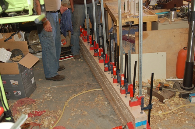

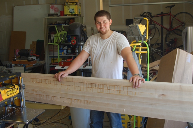

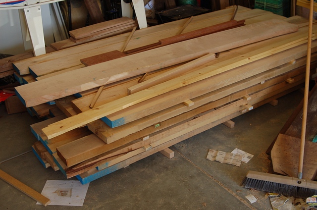

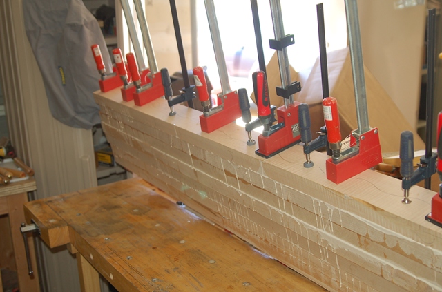

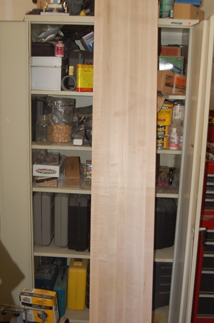

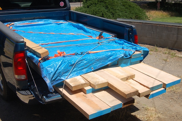

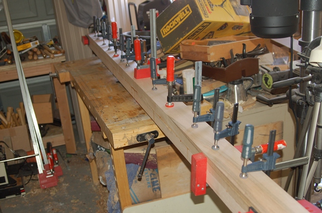

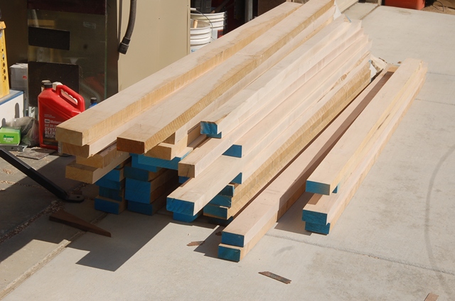

June 14, 201214 yr comment_28978 well guys I am back to my laptop again as my big box keeps alarming for no reason very frustrating here are a few shots of the bench as the work has progressed Thats me the dude left with jOHN Ormsby right striking the deal for..the wood. the rest is the building process from stickering the wood when we got home to the rough cut to the glue up. then the big glue up and the jointing to fit the top in the planer and them Planing to final thickness. The entire Process has been a lot of fun If my bad back will hold out I will get this done in the next few weeks. Remember I am building 3 benches and 2 big one small should be a lot of fun Report

June 14, 201214 yr comment_28976 Lance!!! Do we have a fellow OB dude amongst us! You do realize I was born and raised there don't you! The bench is looking most awesome Dude, looks like you got some good help too. How'd that planer pull that weight through, fine?Lance The Dude Granum said:I cant surf any more bad back shoulders and knees a real bummer man i miss obJohn MorrisThe Patriot WoodworkerProud Supporter of Wounded Warrior Project and Homes For Our Troops Report
June 14, 201214 yr comment_28975 it is the limit of the little Dewalt but it is is the Plane that could it never even complained at all Report
June 14, 201214 yr comment_28974 some how i missed this one the thickness should be as close to 3.5 inches on one and 4 inches on the other the reason i chose the maple is it is a good strong hard wood and will hold up to a pounding yet it is not awful to work like rock maple is and the price was good at 2.50 a board foot and that was a nice way to get it he didnt count the blems as footage very cool john is a great guy. Walter A said:OK, so what is your target finished thickness for the tops? Â And once again... Why "Silver Maple"? Report
