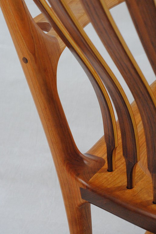

That's a great discussion Walter, there seem to varying opinions on the glue in a joint as far as starvation goes. Lately, or at least the last few years, common practice is to tighten as hard as the material will allow. Glue starvation has been proven to be an urban myth, or shall we say an wood shop myth! I tend to agree with the myth portion of that argument. When building chairs, and when joining the parts together during clamping operations, we can not afford to have any glue joint at all. We love to see the glue squeeze out, the more the better. The glue becomes embedded into the wood fibers performing the actual bond. The joint below is from my rocker I built, and I leaned into those clamps with all my force, looking for maximum squeeze out.
ning-cherryrocker2-28992-23.jpgWith joints like this, zero glue line is a must.
This is a great discussion Walter, glue starvation, or not? I am not a scientist, nor an incredibly smart man, I wish I could tell you I ran my own analysis of this, but I have not, I can only draw on what the wood gurus tell us. I know there must be a joint test somewhere online demonstrating a joint with maximum clamping pressure verses a joint with carefully applied pressure to avoid maximum glue squeeze out. I'll try to find it! Great discussion Walter, I love it when topics go in a discovery mode course!113.gif
