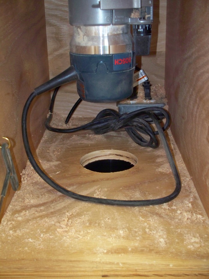

I'm toying with the idea of cutting a 4" hole in the shelf under the router and installing a 90 degree elbow towards the rear.  This will usually sit against the wall and a full 90 through the back would eat up space.  Then I seal the back with 1/4" plywood and install a ventilated door on the front.  I was shocked at the amount of shavings that built up.

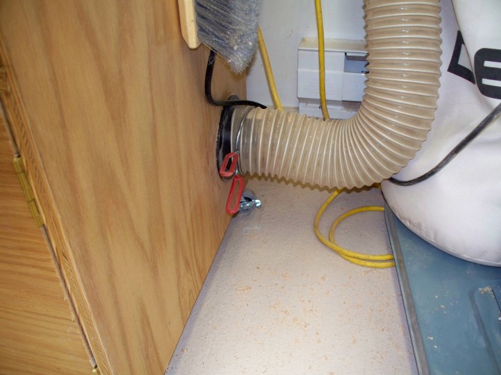

As an added piece of info to you who have seen the table, I added a couple of features to it yesterday.  John Morris asked me why I didn't have a dust collector vent in the router cavity so I added doors to the front and back, and drilled a 4" hole  below the router.  I also drilled a 4" hole in the lower right side of the cabinet and connected the hose with flanges and flex hose and connected it all to the dust collector.  Works great.  Thanks for the inspiration John.

I made some modifications to the table before I started my kitchen project at the suggestion of John and John.  (Morris and Moody.)  They suggested that I port the unit under the router to the dust collector so I did.  I bored a 4" hole under the router and in the right side of the table.  I connected the two with a piece of flexible 4" tubing.  Works pretty well.  Here's the pictures.
