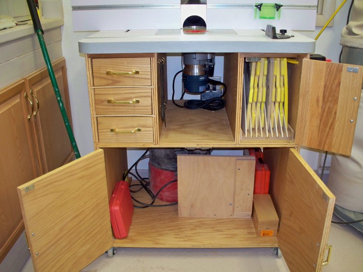

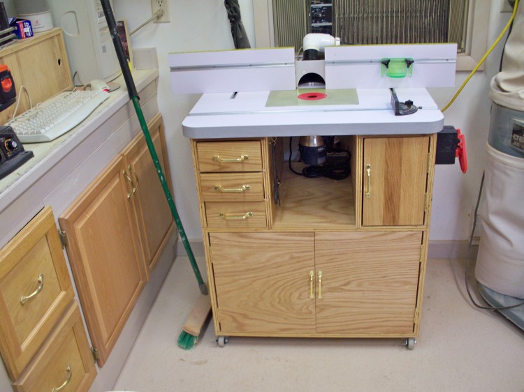

Well, the grandkids have gone home after a week at Pappy's house and I just finished a new router table.  I hung a new Bosch 1617 under it and was able to free up some wall space because I incorporated a slotted blade drawer.
I needed the table to complete my next big project.   Building Nana new raised panel door kitchen cabinets.

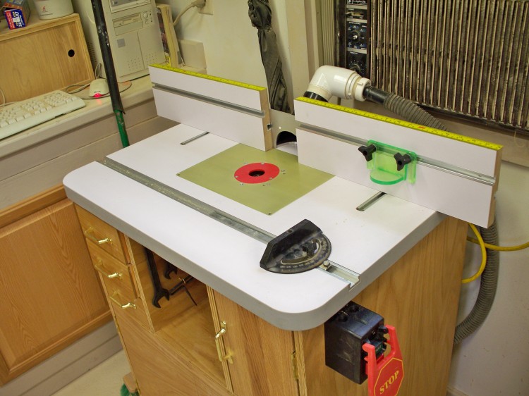

Nice tall fence and the "Panic" off switch is absolutely the greatest!!
Lew Kauffman-
Wood Turners Forum Host
Lew, when you mention "tall fence". I realized that I haven't yet checked the squareness of the fence.  Hmmm, off to the shop.

Holy Molly!!! That is one sweat RT!!!!!!!
 It is solid and you did a great job on the top Ron! What about dust collection?
Wait, I just saw the DC hooked up to the fence area, you need to pat yourself on the back on this one Ron, look like you could eat dinner off that sucker!
Woodpecker insert???
John mentioned the dust collection. That's a neat coupling between the black hose and the PVC. How is that done?

As for the dust collection, right now I have a 3 gallon pancake shop vac under the table that comes on when I start the router.  If it won't keep up, the large D.C. is next to it.  Lew, I'm guessing your're talking about the coupling just before the hose.  That is a compression coupling I found at a plumbing store.

I was just curious, is there a reason you opted for dust collection at the fence instead of utilizing the open box below?
After using it a couple of times and seeing the chips building below, I've asked myself the same question.  On small projects I'll probabaly use it as is but since the DC is sitting next to it I think I'll close the back in and put a 4" port in.

Gotta question Ron.....What base did you use for the router and can you change bit height from the top?

I closed in the area below the router and have a port on the back. I put a door on the front with a plexiglas panel. It has three holes drilled through it near the bottom foe makeup air. When mine is on I pull from the top and the bottom.
