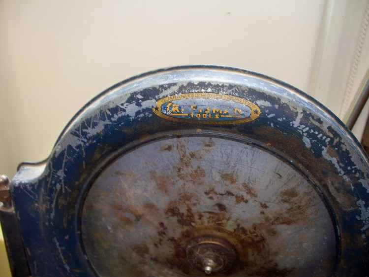

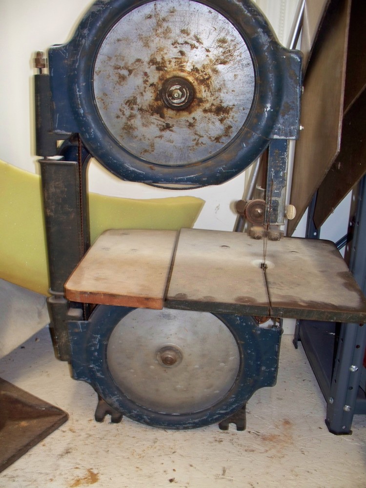

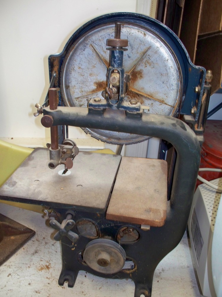

September 13, 201214 yr comment_24057 Actually, I just need an opinion. I have this older Craftsman benchtop band saw and I'm curious of it's age. Take a look at the photos and tell me what you think. Oh yeah, it is for sale, maybe. Edited November 12, 20188 yr by Larry Buskirk Report
September 13, 201214 yr comment_24090 Ron is there a serial number or any number anywhere? I'm not seeing anything in the images that would indicate anything even as far as model. i think it would look great when all the rust is off of it. http://www.etsy.com/shop/nichollswoodworks Edited November 12, 20188 yr by Larry Buskirk Report

September 13, 201214 yr Author comment_24087 It was my father in law's saw and he bought it used in the late 70's. The Craftsman decal has a 60's look to it Jim so you're probably not far off. I think Larry will be able to ID its age. I have a woodworking friend coming to visit so I'm making the barn "presentable." Edited November 12, 20188 yr by Larry Buskirk Report
September 13, 201214 yr comment_24086 Ron, It's from 1935-1936. Manufactured by Walker-Turner for Sears. List price $25.95 in 1935 catalog minus stand and motor. Edited November 12, 20188 yr by Larry Buskirk Report
September 14, 201214 yr Author comment_24085 Wow, I didn't think it was that old. It is pretty but is it worth the catalog value? Edited November 12, 20188 yr by Larry Buskirk Report
September 14, 201214 yr comment_24084 Ron, It was 30+ years old when your Father In Law bought it! Fix It Up! & enjoy it. It looks complete. Edited November 12, 20188 yr by Larry Buskirk Report
September 14, 201214 yr comment_24083 Ron, Here is what the decal is supposed to look like. Edited November 12, 20188 yr by Larry Buskirk Report
September 14, 201214 yr Author comment_24082 Larry, it needs new rubber on the wheels and some guard work. If I keep it, I'd look for a parts machine to make it whole. That is the decal. Edited November 12, 20188 yr by Larry Buskirk Report

September 14, 201214 yr Author comment_24079 As for the wheels, I can probably get them but I have a guard that needs repaired and I may have to fabricate it. Edited November 12, 20188 yr by Larry Buskirk Report

September 14, 201214 yr comment_24077 James, As far as replacing the tires there should not be a problem, they are available in both urethane and rubber. From the parts diagram it appears that this unit uses bronze bushings, not bearings for the axle shafts. From the photos that Ron supplied it looks like this machine has the often missing/damaged ( and hard to find ) blade guide parts. Ron, The guards can probably be repaired. There is a product called Muggy Weld that works with aluminum / pot metal. Edited November 12, 20188 yr by Larry Buskirk Report
