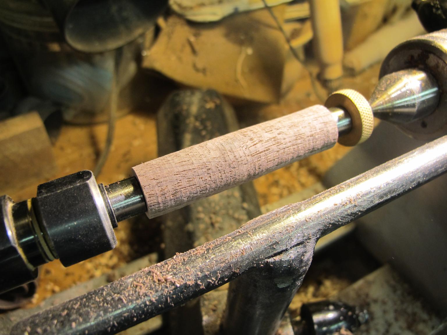

I bought the kits from Craft Supplies because I needed some other stuff that I can only find at their site. Making the rippers is pretty straight forward, especially if you turn pens.  I had some walnut pen blanks I found in a box of scraps. Drilled them with the proper sized bit using the lathe. One trick when drilling pen blanks is to not drill the hole completely thru the blank. Using a brad point bit will have the point punch thru before the bit actually exits the blank. This process keeps the blank from being blown out when the bit would exit.
Once the brass tube is glued into place, the end of the blank can be trimmed near the tube- I trimmed mine on the band saw. Then used the sanding center to bring the wooden blank flush with the brass tube on each end.
I planned on doing a CA finish on these. To keep the CA from gluing the bushings to the blank/tubing I apply a coating of bumble bee butter to the bushings.
Then mounted the blank and bushing to the pen mandrel.
Then the assembly on to the lathe
Rounded the blank with a roughing gouge
Shaped with the skew
Sanded the blank to 400 with Abranet mesh to 400 and finished off with Abralon pads to 4000. Applied some sanding sealer.
Then about 40 layers of thin CA-
Assembled the parts with my shop made pen press
