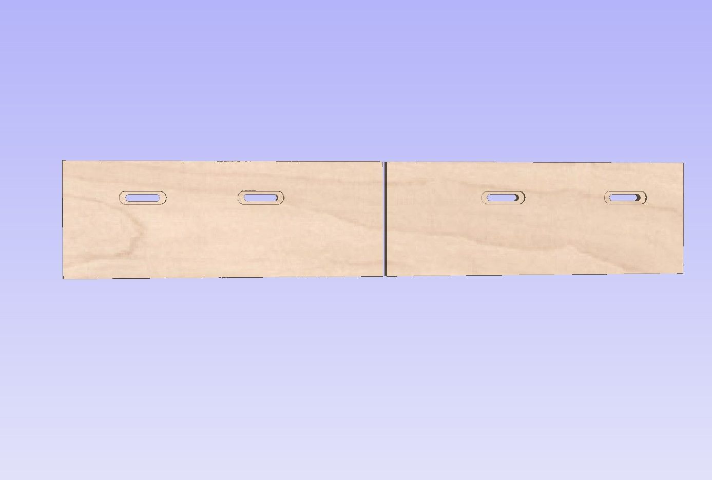

Reminded myself this morning of teaching days when students were afraid of cutoff kickback and cutting small parts on the big compound miter saw which I also own. I drew up these to cut out for my own saw, and I'll send the file to the college lab manager. The saw has 1/4" x 1/2" holes in the metal fence already. I'll add a photo of them mounted on the saw after I cut them out later. Prior to this I've just used small c-clamps to clamp on plywood scraps. These will use t-bolts I already have and either cam levers or wing nuts on the back side to loosen/tighten or remove them. The gap between the metal fences is indeed a danger. This will be a permanent attachment to my saw so I can put my tiny c-clamps to other uses. The wide slots allow me to pull them 1" away from the blade, then I can loosen the metal fence they are attached to and slide it back for miter cuts. I'll cut these from a scrap of cheap 1/2" thick birch veneered plywood I have. 4D
