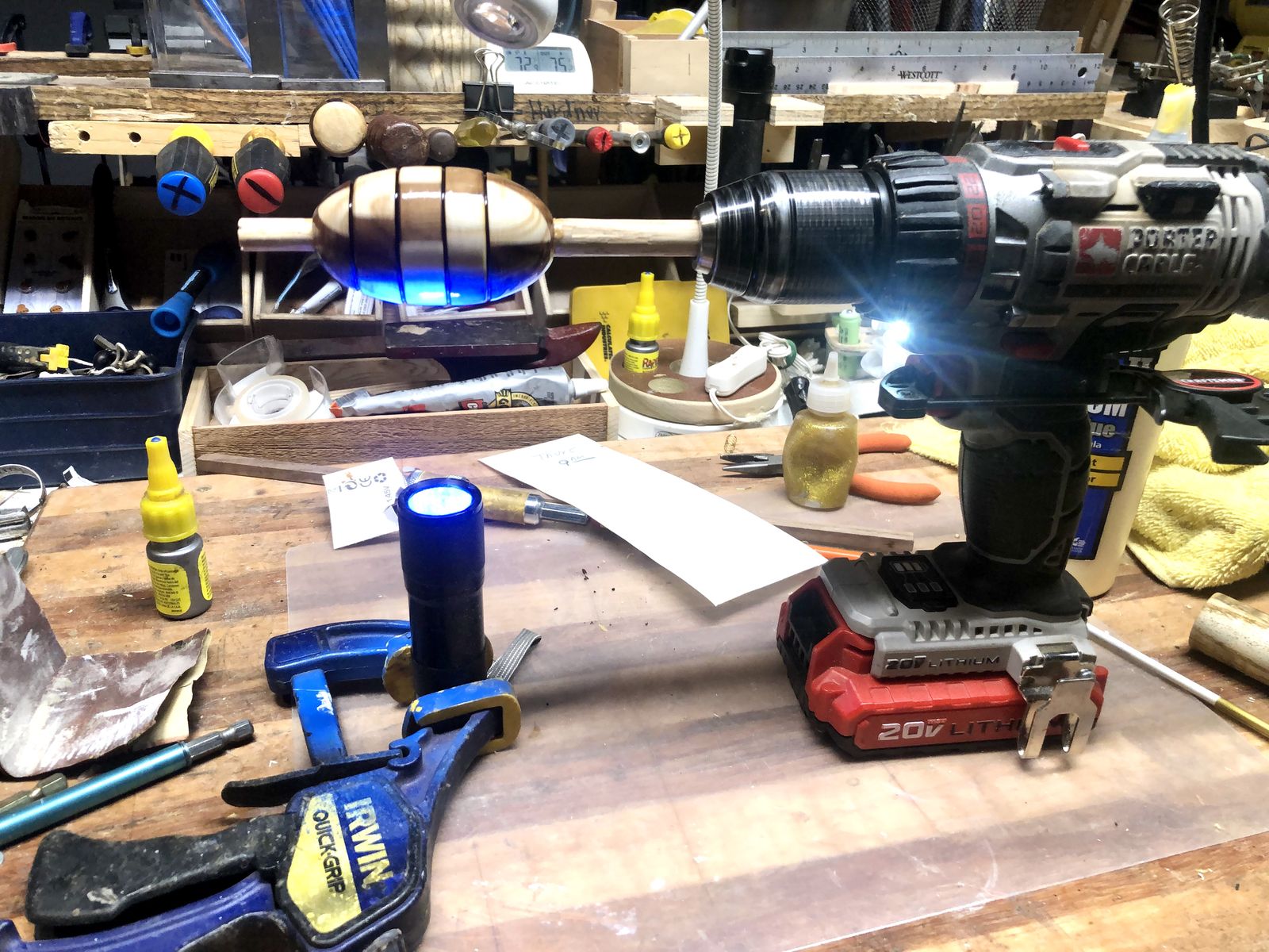

  1. Ron Altier
    Ultraviolet finish update, again
    I got an idea how to use this finish. It only hardens with an ultraviolet light or sunlight. My biggest problem with it was that it would harden and look lumpy. So I set up my drill to turn the piece while a ultraviolet was held below. I used clamps to regulate drill speed and hold the small ultraviolet light in place. It appeared to work well. I allowed to to slowly harden half way in the drill and took it out in the sunlight to complete hardening. While this concept is good, don't drop it in the grass. I did. Yes it got grass and other assorted stuff on it. I will let it harden and will take it back in and redo the whole process. I think this process hold promise, as long as I use sunlight to finalize the process (and don't drop it). It hardens much better in the sun than the battery powered one. To be continued
