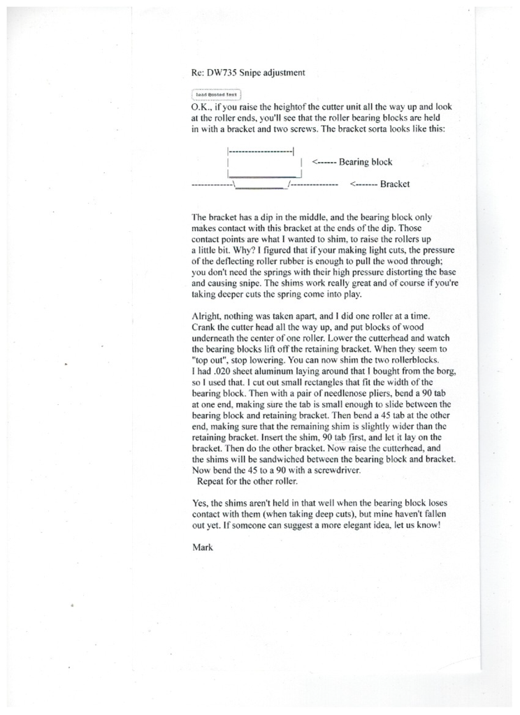

  1. I have been in contact with Shelix about getting snipe for a little over a year now. They tell me that they know they have a problem and are working on it. You guys that have a DW735 and are getting snipe with a Shelix cutter head please help and call Shelix and maybe we can put a little pressure on them. If you have fixed the problem please please post the fix. http://www.byrdtool.com/shelix
