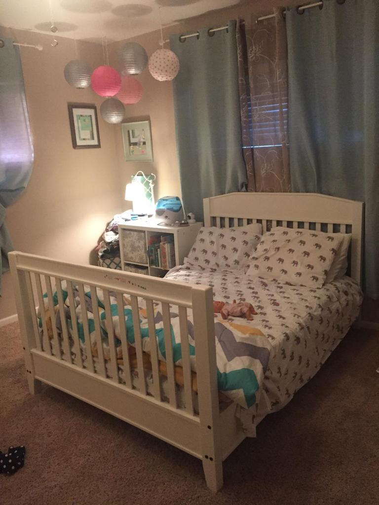

  1. kmealy
    crib retro-fit
    I started this last weekend and now it's done and finish is dry. Customer wanted the bump out to hold a boom removed. Before pics Phase 1 to get the reinforcing block off the bottom. Remove the screws With a circular saw, cut the block into strips Chisel off the strips Clean up the base with chisel and sandpaper Phase 2 cut off the bump Make a fence from a scrap 2x4 that bridges the rails across the bottom Set the fence so the circular saw will trim off the bump without hitting the spindles Make the cut Finish up the last 1/16-1/8" with a hand plane Round-over top and bottom with router Sand everything Run some test finishes on the bump cutoff. Boiled linseed oil looks good Apply 2 coats of BLO Let dry a couple days Clean up some old scuffs Buff off with 0000 steel wool
