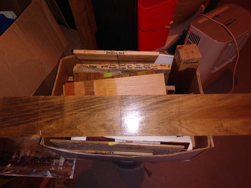

  1. kmealy
    wood conditioners & wash coats
    (On other forums) I keep seeing people recommend wood conditioners. Flexner (as well as I) were puzzled why they work so poorly when used as directed. I don't use them much but find much better luck with better quality stains. But I repeated his experiment on a piece of poplar with a popular yellow can wood stain. Various wait times from left to right are 0 minutes, 30, 60, a few hours and overnight. While still not perfect, it's a vast improvement. Lately, I've done a few experiments with a dilute (1/2# cut) shellac, and that is showing promise. Wood conditioners Wash coats
