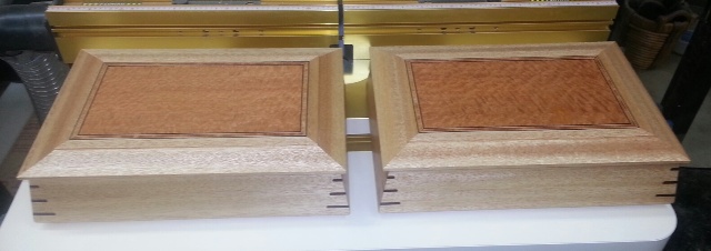

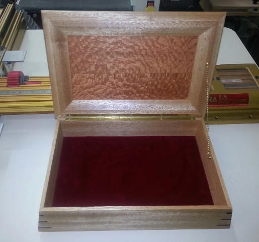

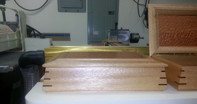

I've been working on these for awhile and finally getting the time to finish them.
Both Jewelry boxes are made with Mahogany for the case and lid frame, walnut splines for the corner joints, Lace wood veneer and banding around the Lace wood for the lid. the finish is General Finishes clear sealer and 4 coats of clear matte wipe on poly. The bottom is covered with red velvet. I'm debating on adhering a mirror to the inside lid but trying to find a thin one and someone that can cut it exactly to size. The dividers (not shown yet) are made from Maple that I'm Ebonizing with India ink. Once the dividers are dry I'll post the completed pics. Thanks for looking, and comments good and bad welcomed!

Gorgeous, Mike!
A mirror would be nice but it might be ashamed to cover the beautiful grain of the wood. Of course that's a man's point of view!

That is some very nice work!!!
How thick is the wood you're working with?

Ohhh pretty.   Nice work and nice choice of materials.
How do you like the Incra?
Thanks Lewis!
I felt the same way Lewis but my wife suggested a mirror. I think I'll keep it the way it is. Thanks Lewis

Thanks Harry!
The case is made from 3/4" re-sawed to 5/8" with a 1/4" Baltic birch ply which is covered on both sides with velvet. Once the case is assembled with the splines the case is routed on the bottom with a round over bit then the front, back & sides are cut with a bevel to reduce the upper thickness to 1/4".  The lid frame is 3/4" stock assembled and then the outer lip rounded over the bevel cut to reduce the appearance thickness and give it a coffered look .

Thanks Cliff!
I love my Incra router table fence and table top. Worth every penny spent!

Wow Mike those are awesome. Beautiful wood with very nice grain patterns. Love the lacewood and the walnut inserts on the corners.
I almost feel like Lew, the mirror would cover that beautiful grain but it probable would be nice. Most glass places can cut the mirror to what ever size you need. You can even get beveled edges.

Thanks John!
I'm going to leave the lid as is, I can't bring myself to cover it up.

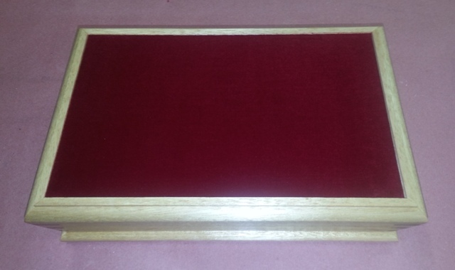

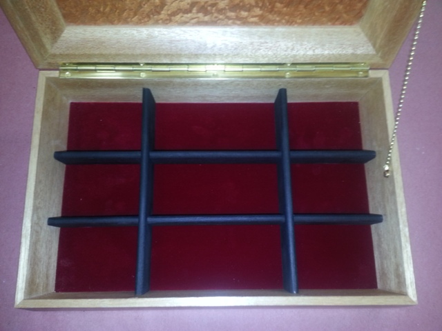

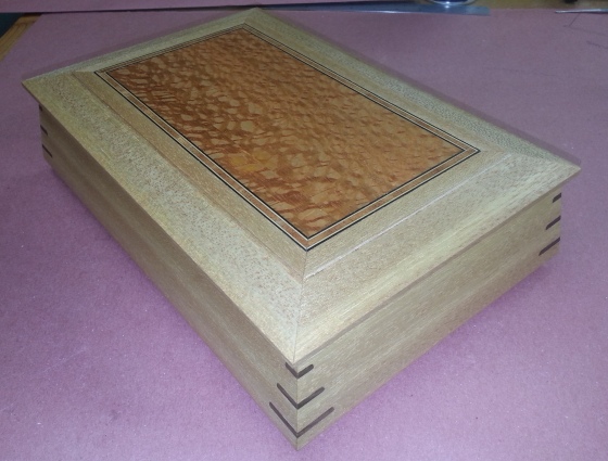

Here's the box with the Ebonized Maple dividers and a pic with the velvet attached to the outside bottom. I then applied 3 coats of hand rubbed wax.

Very nice. Love the dividers.

There is nothing not to like about those boxes, Mike. They are just gorgeous!
No mirror was a good choice, too. Love the dividers.
