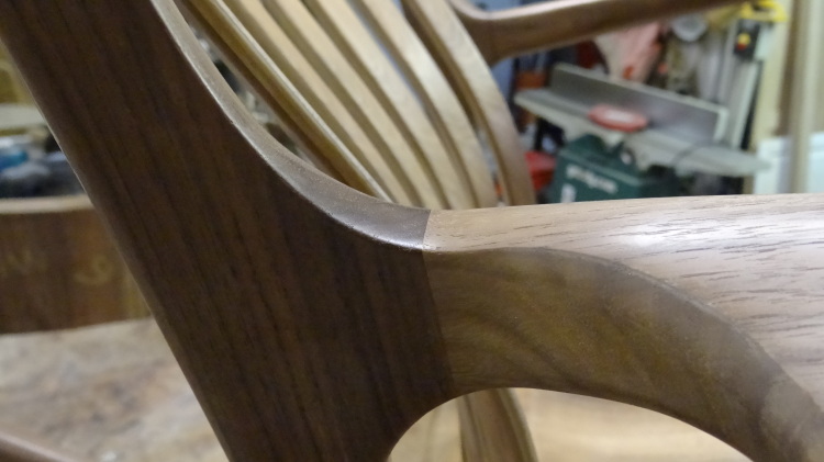

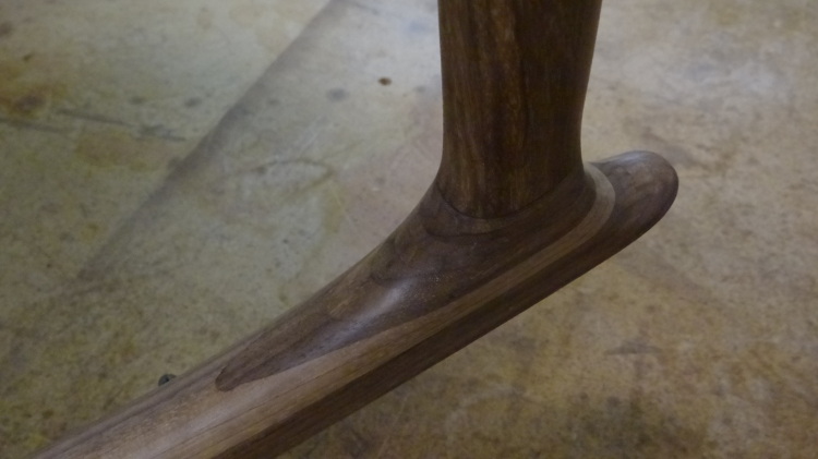

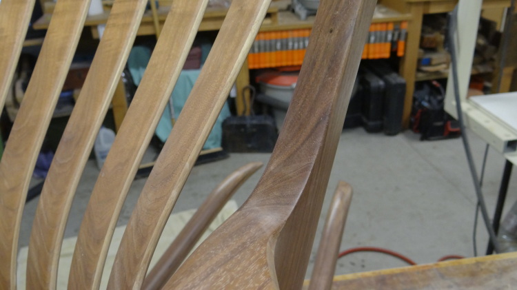

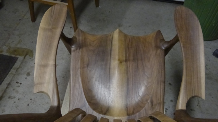

After getting the entire chair sanded and buffed to a keen 1200 grit, we then applied the first coat of BLO to the chair, I really like this part of the process, there is a lot of satisfaction in watching the grain come alive.
First some before shots before the finish is applied.
ning-walnutrocker5-13602-83.jpg?width=75
ning-walnutrocker6-13602-56.jpg?width=75ning-walnutrocker7-13602-64.jpg?width=75ning-walnutrocker8-13602-38.jpg?width=75
ning-walnutrocker9-13602-6.jpg?width=750

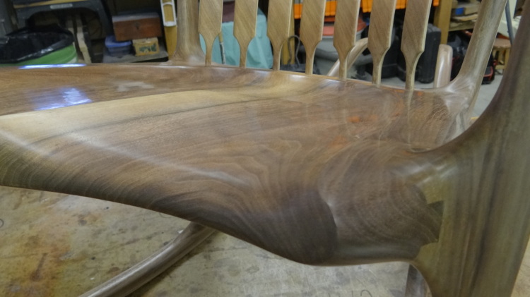

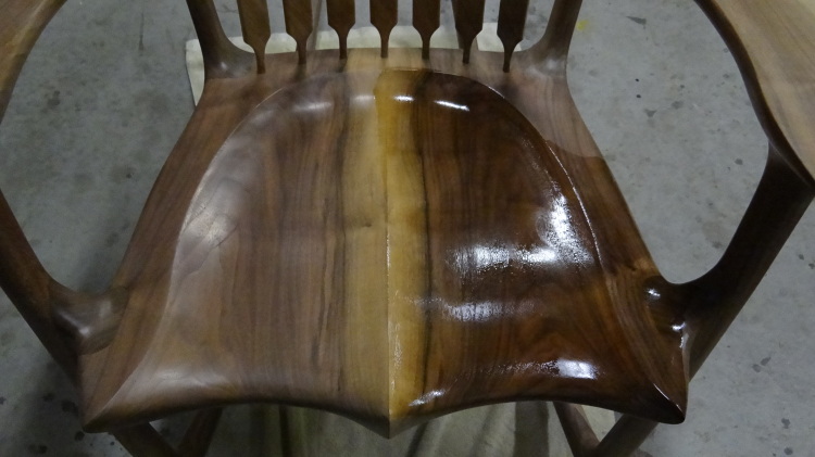

Then the fun begins, the first and following two coats of finish I went with BLO. I think I will stick with BLO on this chair as the final finish as well. Because the chair was sanded and burnished to a fine sheen, the BLO is able to capitalize on that process and appear like a finish coat with it's deep rich semi gloss characteristics it picked up from the sanding process.

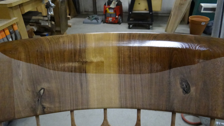

I wanted to show the difference between natural wood and finish, so I took a swipe at the headrest and let the wood do all the talking.

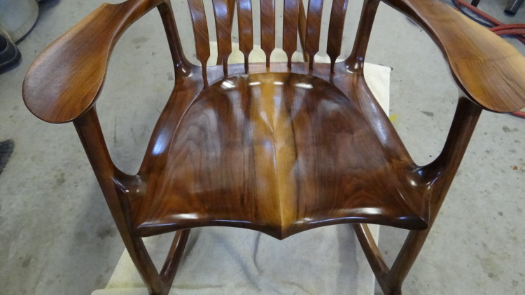

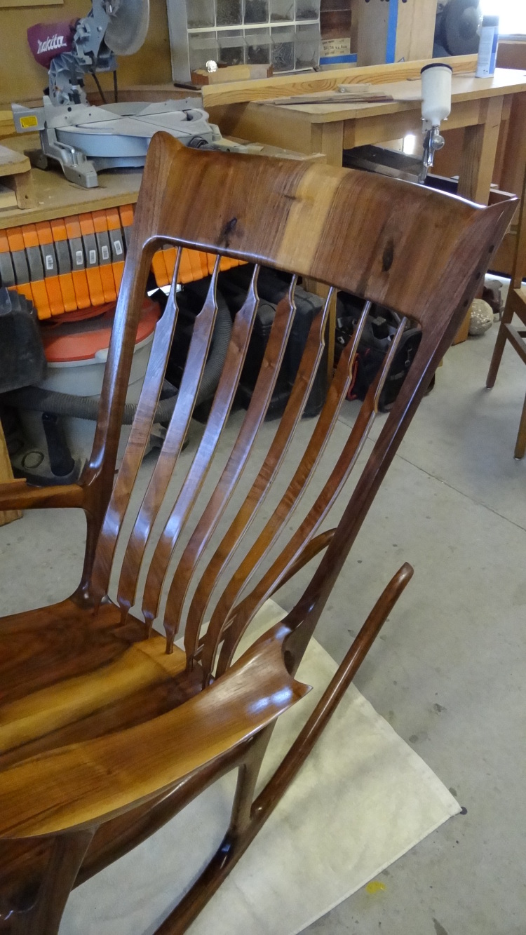

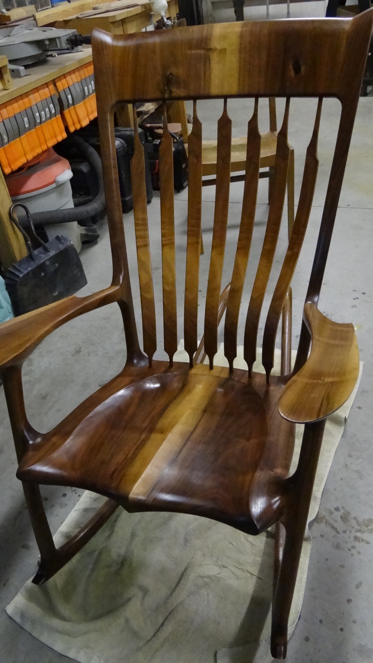

Then some following images of the finished chair, I just got done putting the 3rd and final coat of BLO on the chair, it looks patchy and spotty right now as the BLO soaks in after I gave it a preliminary wipe down. But you get the idea of what it will look like by tomorrow. After each coat of BLO you need to revisit the project a couple hours later and wipe any leaching oils from the surface. If you don't, you'll have a spotty surface.
ning-walnutrocker16-13602-44.jpg?width=7ning-walnutrocker21-13602-45.jpg?width=7ning-walnutrocker19-13602-85.jpg?width=7
ning-walnutrocker22-13602-68.jpg?width=7As I type this it is almost time to head out to the shop and visit the chair again and see if any finish is beginning to leach out of the pours of the wood. I'll probably have to wipe it down about 3 or 4 times throughout the day to smooth and buff the finish.
I really like this method of finishing, most of the finishing stage is done up front with the sanding to such a fine grit. The chair is 95 percent finished with the last grit of sanding. All you have to do at this point is just wipe on and wipe off, no runs, no sags, no dust nibs. Another benefit of this style of finishing is the finish is in the wood. There is no layer of finish that appears plastic or fake, it is completely natural.
