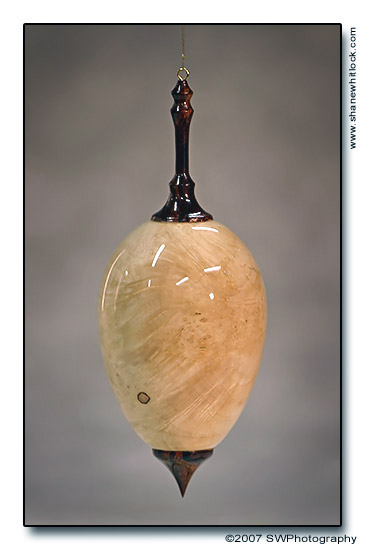

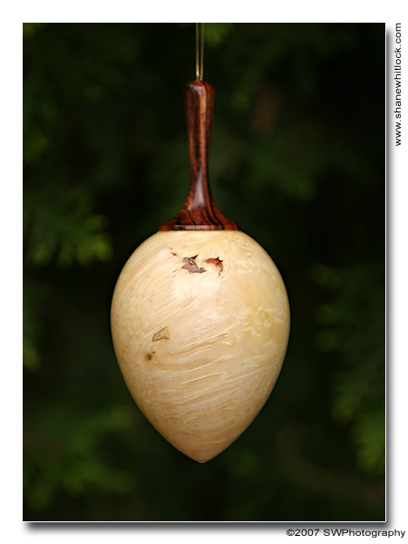

December 13, 201312 yr comment_6750 I can't remember if I posted this here before or not so here it is again. This is a pictorial I put together a few years ago to make these Holiday Ornaments. Click HEREÂ to go to the pictorial. Click on the thumbnails for a full sized image and a description of what I'm doing in the pic. This is what they look like. If you make one please post a pic. Report

December 14, 201312 yr comment_6762 Very Nice Shane! What types of wood did you use? Larry Old Woodworking Machinery Forum Host Report
December 14, 201312 yr comment_6761 I checked out the pictorial, did you turn the main body as you did the finials? Report
December 14, 201312 yr Author comment_6760 Thanks for the comments guys!Larry the wood is Box Elder Burl and Cocobolo. The finish on most of them is CA and BLO.Tony, I'm not sure I understand your questions. I turn the main body first so the finials can be sized to fit the openings. Is that what ya meant?I should of mentioned above that you can click on the thumbnails for a full sized image and a description of what I'm doing in the pic. Report

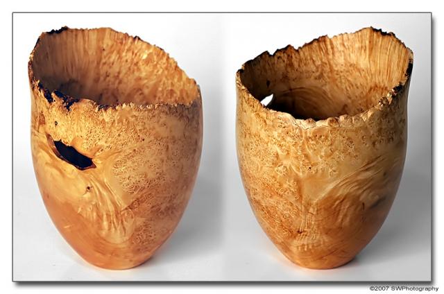

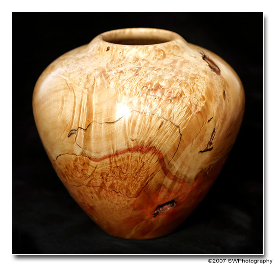

December 15, 201312 yr Author comment_6757 The burl on the Box Elder tree can be some beautiful wood with some wild grain as ya can see in the pics below. We have a lot of it here too, in fact, the county I live in is called Box Elder county ... lol Report
December 15, 201312 yr comment_6756 Shane, I'll have to watch for the burls when I cut up the Box Elders. I always thought they had some pretty wood with the red streaks running through it. I've never tried making any lumber from them, but have to wonder if the wood would work like other Maple species. Have you ever made your own syrup? Being that they are a member of the Maple family, I tap them right along with the other Maples.  Larry Old Woodworking Machinery Forum Host Report
