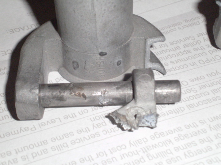

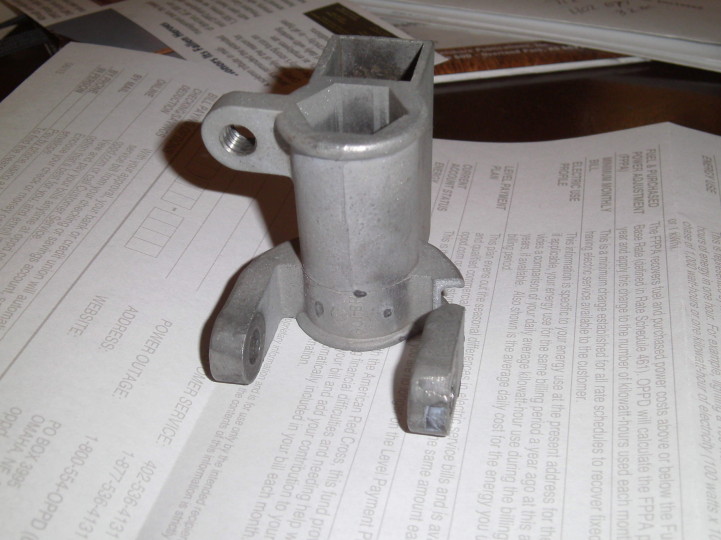

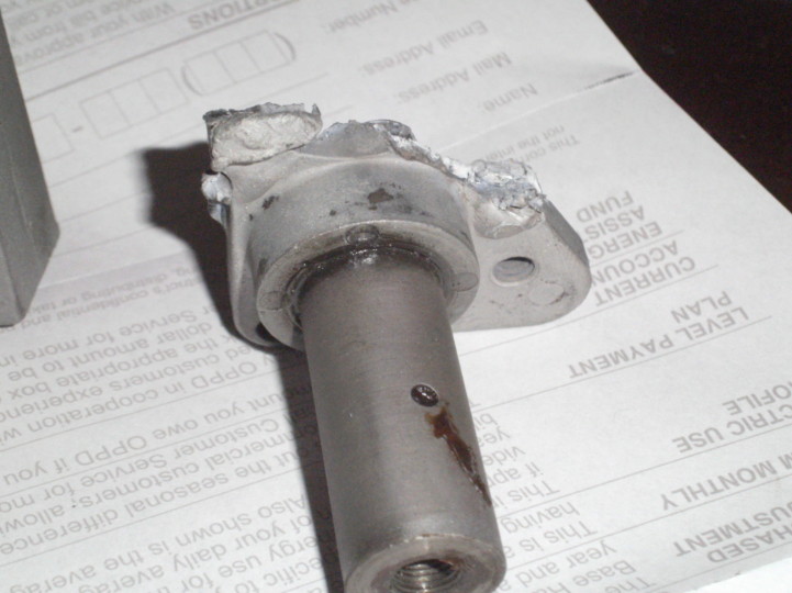

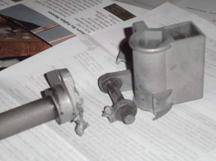

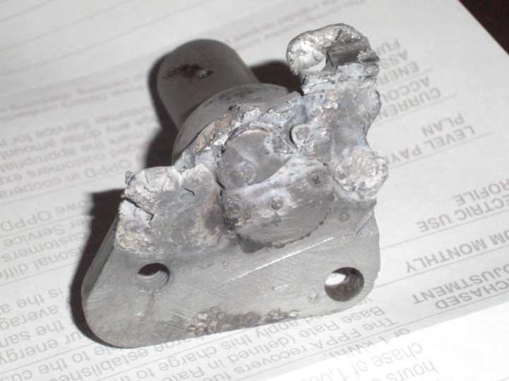

February 7, 201412 yr Author comment_5439 Ok, Got the parts back and they are in much worse shape than when I dropped them off. In fact I am afraid the parts are so bad as to be beyond salvage. Here are some photos. First, all parts as they should go together The shaft on the left is where the upper wheel attaches Here is the bracket to the right. When I gave it to him, it was all together with no broken parts. As you can see now it has one of the ears broken. I think this might be fixable, maybe with muggy weld? As you can see the right shaft holder has been broken off. I suspect it was broken when they tried to get the shaft out. Here is how the pivot bar is supposed to fit. I think the rod was driven on after the part was heated. But I could be wrong. Here is the shaft plate/shaft. As you can see its pretty buggered up. I really don't think there is any hope of doing any thing with this part. I don't think there is enough here to work with, even if I can find a way to weld it. The worst part is that I don't have any better photos than the one I originally included. So unless I can find someone with one that I can get measurements from I may be out of luch. Here's the shaft from the other side. I think I'll try to punch out the shaft first, then see what I can do about the plate that it is supported by. I'm just not too hopeful about finding the parts I need. I may just clean things up and either part it out, or just put it in storage until I can find the part I need, then finish the restore. If anyone has any ideas, I'm all ears. This is a nice saw and from a great era. Report
February 7, 201412 yr comment_5438 Oh My what a hash that got turned into. What was the purpose of this other person's possession, however temporary? A loan? Conceivably the whole part could be fabbed up with a stick welder. a slow speed drill press. and an angle grinder to cut the steel. Even the hex to go on the shaft. 1/4" should be heavy enough for most of it. I'd make the hex by clamping cut out steel coupons to the hex shaft (sprayed with anti splatter) and tack-welding them together. Then finish welding the bulk on the bench. If no square tubing can be had the size needed then maybe repeat that process to fab the internal square too. Once that was built the rest seems pretty straightforward. To mount the shafts, I'd not go for a press fit. I'd drill and tap for allen bolts to pull the shafts against the collars, or just weld 'em in permanently Other than that, I suspect it's a search for parts on the web. Have you posted on OWM? Report
February 8, 201412 yr Author comment_5437 Cliff, Thank you for your insight. I let him take them to fix the parts. I thought he could weld anything, at least that's what he told be. He's a very good friend and a customer for my other business, so I thought I should give it a shot. Never again. As for fabrication, I think I can muggy weld the ear on the larger piece. Then, I can draw up the wheel mounting fixture. I'm not sure its all there after I looked at it. I may have to fiddle a little to try and figure out how it all goes together. AS for OWM, you have to be a member to post as with most forums. The problem is with the originator. He has a problem with any mention or even inference to Craigslist or any other classified source. I have no idea why, it seems stupid to me, but its his forum, so I left after two years as a member. Too bad to, because there are some really great people on that forum as there are here. I can still read it of course, and the Vintage Machinery .com site is invaluable. However, nothing on this particular saw. I have more research to do, but nothing so far. I just missed the part on ebay a while back. So I'll keep looking. But, thanks for the ideas, I will look into them. I don't have any way of welding, don't have a welder, not sure I have enough power in my shop to even support one. I only have 20 amp service to the shop. Report
February 8, 201412 yr comment_5436 Welding cast iron is a real beast. I dunno nuthin bout muggy But I do TIG MIG and stick like a real amateur. Which means it don't look great, but it sticks together when I'm done. I've done cast iron before - and - after I knew what I was doing. My "before" was a disaster - - like what you have. I don't think there is anything that can be done with that. It looks like it suffers from the same problems I had. After I learned how to do it, I stopped trying to do it on any thing larger than small stuff because I don't have a heat treat oven that can go to 900F and If I can't heat the entire part evenly with MappPro, then I can't pre-heat it properly. So there's no point. The problem with cast is the thermal expansion. Cast iron really expands like crazy when hot and the nickel weld rod not so much, so you can weld a spot in the casting and as it cools it all pulls itself apart like it was rotting cheese. and POP the welded area breaks free of the rest. So ya gotta heat the whole part not just the area to be welded, but the entire part - even if it's an engine block - ya gotta heat the whole bleeding thing to 900F or higher. And then ya gotta control the cooling rate. The Muggy weld stick is $130 a pound. For that they should include a full on girlfriend experience with a room full of supermodels. I don't think they can help you though not muggy and not Certanium either who makes a wonderful cast iron stick welding rod for a thousand dollars for 10 pounds. Reason I don't think they can help you is that the damage is already done. The cast iron is already stressed and cracked and there's just no way you can know how bad the damage is. I suspect if you magnafluxed and X-rayed the part you'd find it is a whole pack of spider cracks. However what's the harm of trying? What's the worst that can happen? It won't blow up and kill anyone. Maybe they'll send you a sample. Maybe you can find a local welder with a certification who will discuss it with you. Report
February 8, 201412 yr Author comment_5435 Cliff, Many thanks. But the parts are not cast. I am not completely sure what they are, but my bet is pot metal. My friend thought aluminum, then tried another method, but nothing worked. That's why I was thinking about muggy weld. At least for the dog ear on the large piece. At least I'll give it a try to see what happens. Most people I've talked to have said you can't weld pot metal. I am thinking about building a small foundry, I have all the components, so if I get it done, I have plenty of scrap potmetal around that I can use to cast new parts. The large piece would be a real problem to cast I think, but the smaller piece shouldn't be much of a problem. That would be fun to try at any rate. Report
February 8, 201412 yr comment_5434 Hmmm Pot metal for a highly stressed part? I dunno 'bout the wisdom of that. It's great for compressive strength but that's about it. It has absolutely nothing for a Young's Modulus, no hysteresis characteristics at all. Once it's flexed, it's toast. I bet the alloy you have is ZAMAK which was better than pot metal and there's a couple versions of it still in use today. Zamak is zinc, copper, aluminum and magnesium. Great for die casting. Heavily used starting in the 1930s and later Report
