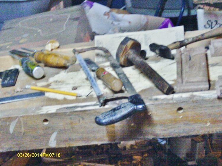

Then, after all that fun. Started the layout lines. One set was in 3/4" from each end. A second set of lines was 1/4" in from the edge, and a 1/4" in from the face of each blank. Then ( and this is a clue) drew a 45 degree line from the 3/4" line and the corner of the end. Gathered a few other hand tools up
ning-imag0026-3865-71.jpg?width=750

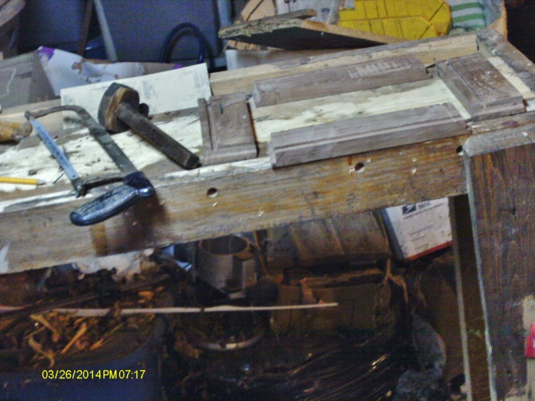

Yep, that is a HACKSAW sitting there. The main backsaw was having "issues" with about any sort of a cut, today. Got out a smaller backsaw, it worked for one or two cuts, then it had bending issues....
So a hacksaw was used to make the rest of these cuts. Clamp a blank into the old metal vise, mark out for the 1/4" rebate on the end. Saw down until I hit the 45* line.  Seems the blade on the hacksaw is 1/2" wide, so as soon as it is flush with the top, stop and check the lines. Then a rap or two against the end to knock the waste off, and finish up with a chisel.

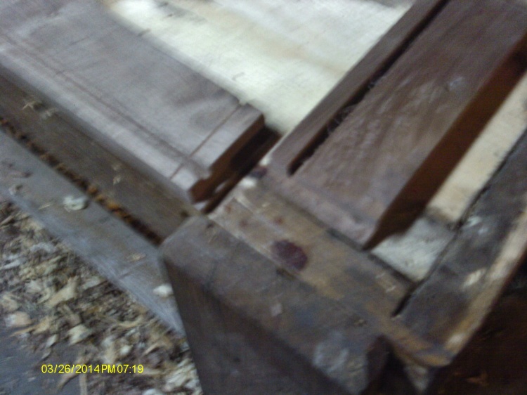

ning-imag0027-3865-78.jpg?width=750
a fuzzy-wuzzy before and after shot. Took awhile, but all the ends were donening-imag0024-3865-22.jpg?width=750

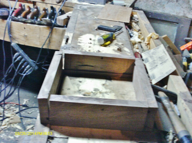

Next up, ( after a Mountain Dew break) layout of some pins. Since this kind of dovetail, you have to lay the pins out first. Just isn't a way to do it the other way around.
ning-imag0022-3865-2.jpg?width=750
This is where we started. When done, it will look like a miter joint ( I hope) as those dovetails will be "Hidden". Stay tuned, chapter three is being studied right now.....

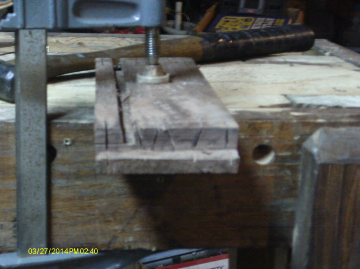

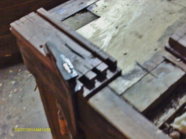

Sketched out a few pins last night, and tried a bit of chopping them out.
ning-imag0021-3867-8.jpg?width=721

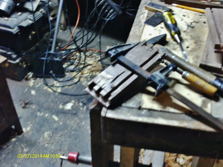

Hey, little shaky in the hands, ok.  One end wasn't too shabby, the other one ning-imag0023-3867-53.jpg?width=721
Had a bit of a blow-out, hence the clamp. Grain went one way, I wanted to go the other. A little titebond to the rescue. Later, will use this to lay out the tails, and then.......the mitre cuts.....should be fun

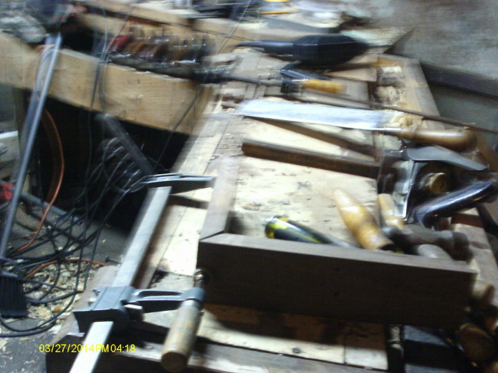

Couple more hints at what these will be
ning-imag0024-3866-51.jpg?width=721
Still have a bit of fine tuning to do on these dovetails.....
