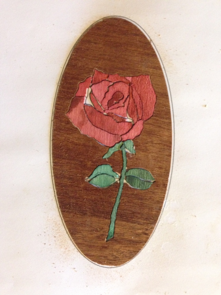

Currently working on a book on making Inlay Medallions. Tried a dyed rose last week. Not a bad first attempt, but somehow lost a few parts in the dying process!

I got the new rose cut out today. This time I added brown paper to the back of the veneers. This prevented the small parts from splitting and was quite a help.
The photo shows the parts assembled but obviously not attached to anything.
This afternoon I dyed the stem parts green and the petals red. I hope to get them hot sand shaded this weekend before gluing it all up.
Today I sand shaded the stained parts and dry fit everything. Tomorrow I'll glue it all up.
