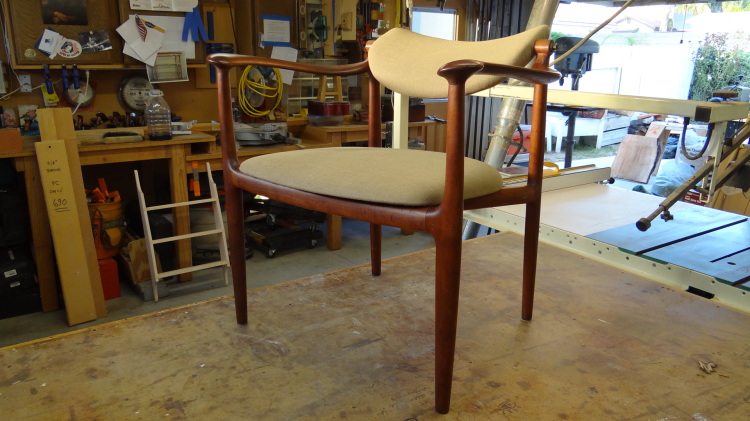

A friend of ours has this beautifully fun, classic chair that she is not sure where it came from except that her brother has had it for over 40 years I believe. The lines are completely cool, the arms if you look at the end or fronts of the arms almost have the old colonial arm chair look with the slenderness and the round tips.
Since it was probably built in the late 50's or early 60's, during the height of the Danish Modern period, I am surmising that it is just that.
The problem with the chair are the joints are dry and loose. My mission is to pull the chair apart at the joints, and re-glue them and tighten the chair up considerably.
Afterwards we'll steel wool it to clean it up then oil it to bring it back. Nothing I do will disturb that fantastic patina it has built up over time, so rich and deep, just gorgeous.
The back rest is on a swivel of sorts, I have not sat in it yet, but I bet that adjustable back rest is very comfortable. A really cool idea.

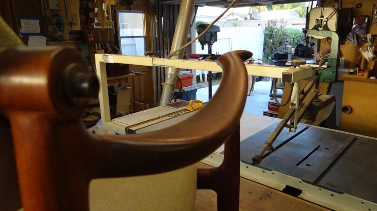

ning-danishmodern-2607-5.jpg?width=750ning-danishmodern6-2607-87.jpg?width=750
Photo above, you can see some of the blemish's that are in the chair, most of these appear to be the chair bumping into a painted surface such as a wall etc. Those will rub out easily.

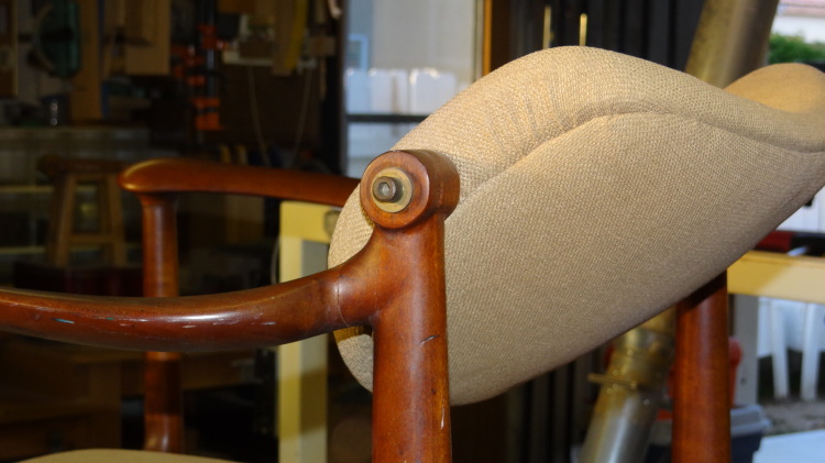

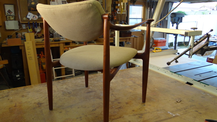

ning-danishmodern9-2607-32.jpg?width=750ning-danishmodern10-2607-16.jpg?width=75
Photo above, I just love that graceful arm.

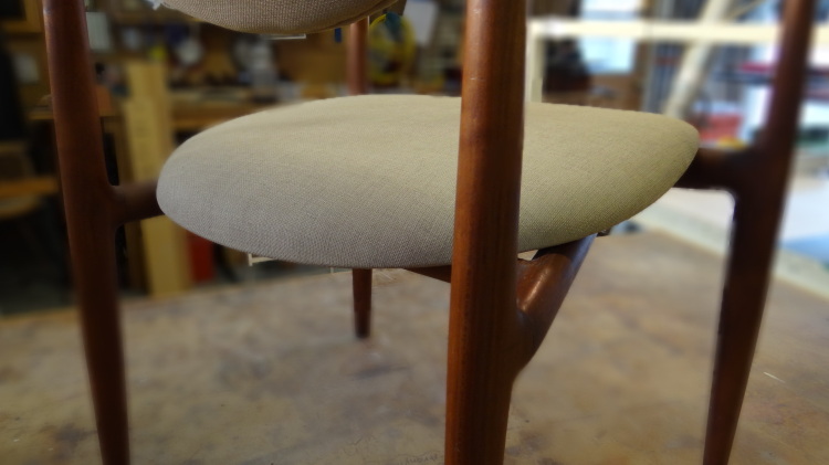

ning-danishmodern11-2607-33.jpg?width=75

Is that cherry? The hand work in those shapes inspires me, might save these pics and build one with Elm. I'd make a few changes, that bolt head needs to be hidden, maybe a wooden head over it.

I agree about that bolt head, that was kind of weird considering the elegance of the rest of the chair.
