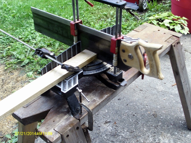

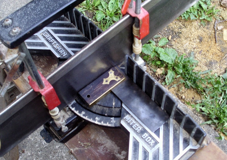

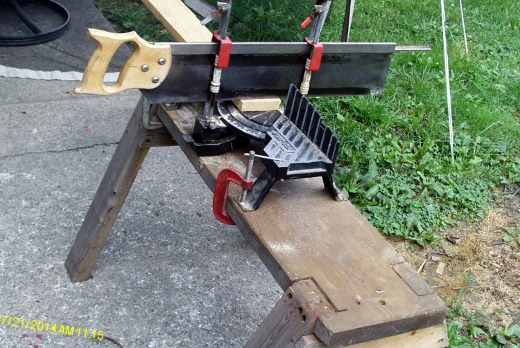

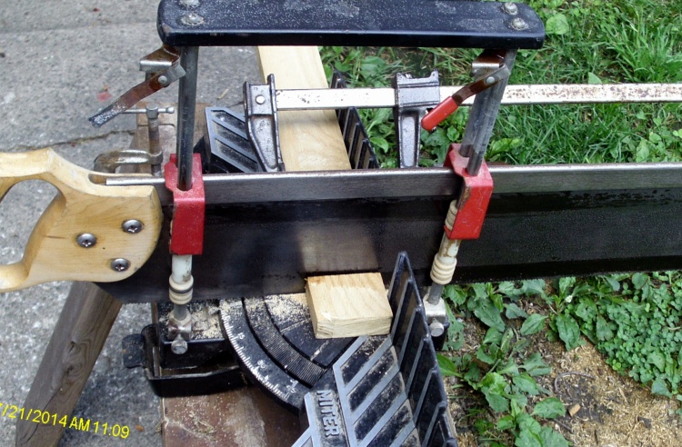

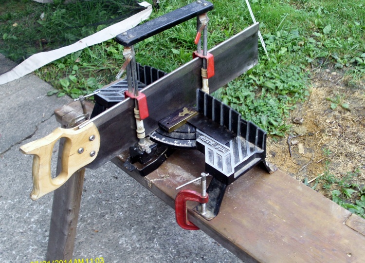

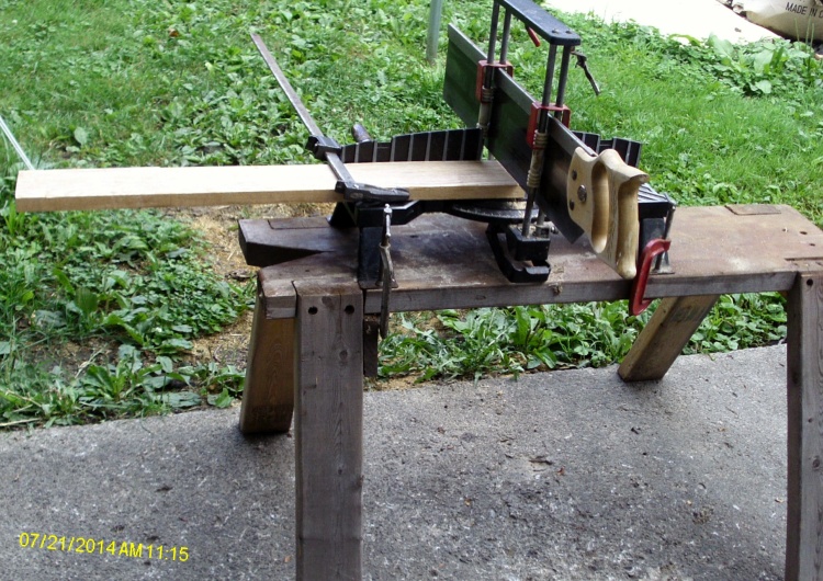

July 21, 201412 yr comment_824 Have a saw bench outside on the back patio, nice day outside, might as well set up that "New" Mitresaw for a test drive? Didn't want to mess up the saw bench with screw holes, so a couple clamps to hold it in place. Try square to check the settings Looks good from my house. had some Oak parts to trim to length Seemed to bind a bit in the cut? Some Dummy forgot to wax the saw plate, Duh. Had some 3in1 oil handy, since I oiled the moving parts. Just a few drops, and let the saw spread it out. Cut a lot better. Almost a glass like surface, too tried out a wider board. Not sure how wide I can go on this saw. I used a clamp to hold the wood in place, seemed to work better than me holding and sawing at the same time (like walking and gum chewing?) results of the wider board Might not be too bad a saw, for $5... Nice part about this set-up? I can SIT DOWN and saw. LOL Report
July 23, 201412 yr comment_826 That is one sweet tool.Tuned up even the Craftsman miters are great. I wouldn't use it to invade Afghanistan in a land war, but I'd use it for cutting pretty much any stick of wood. Report
August 28, 201412 yr comment_825 Nice little setup for $5. There is one locally that a guy wants something like $50 for the unit that looks like yours. Report
