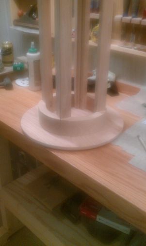

August 9, 201412 yr comment_525 Ron I made a small round lamp table for our livingroom. What I did on the skirt was to lay out the pieces for the curves, laminate them together then cut them out on the band saw. worked out good for me. Here is a photo of the dry fit. I also inset the legs a little so the skirt travels all the way around and is almost seamless. Hope this helps. To attach the top, I drill straight down the bottom of the skirts and used glue and screws. That way they were hidden. You may need to to attach a thinner skirt with pocket screws. Report
