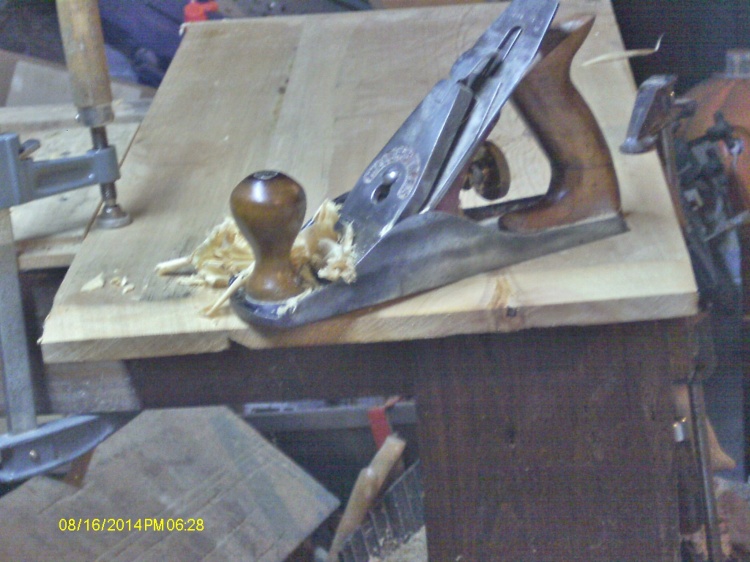

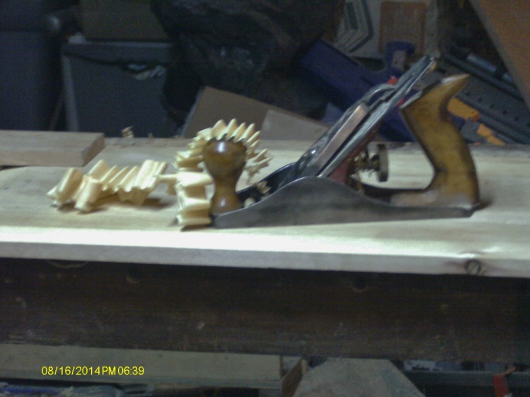

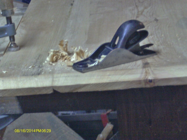

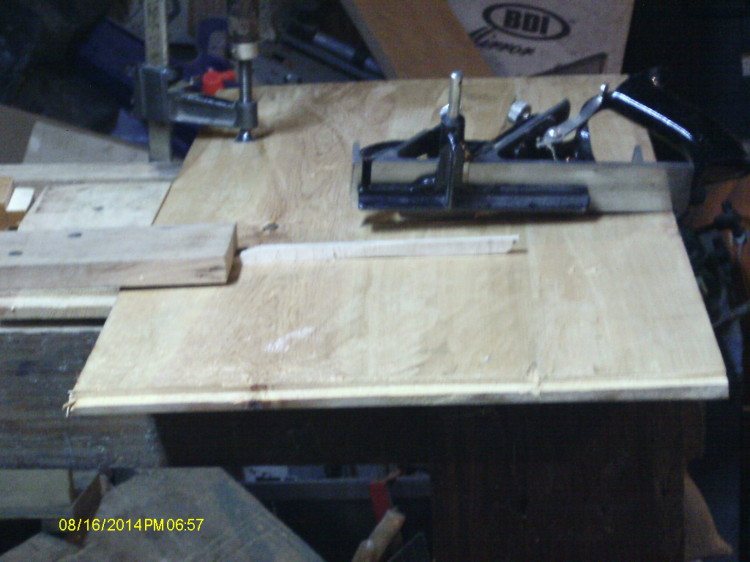

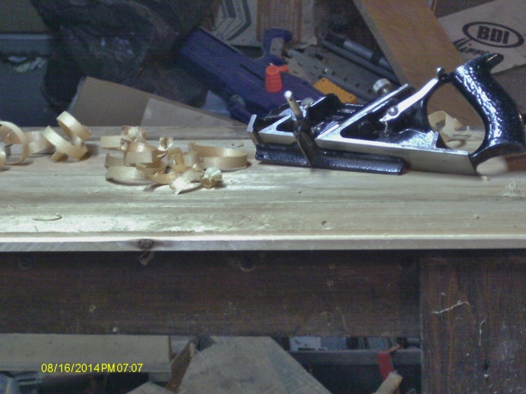

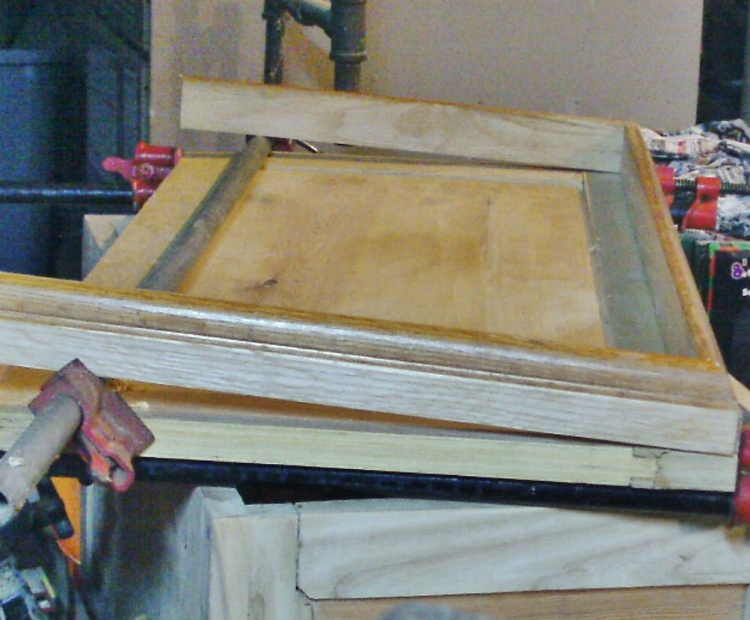

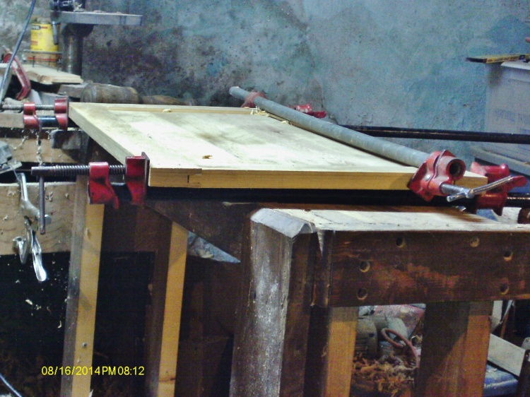

August 17, 201412 yr comment_448 Assembled and in the clamps. Awaiting the glue to cure, then add a couple trim pieces, and a pair of hinges. Lid was a frame (Oak, mostly) and a raised panel of pine. Have to use what I have around the shop. Lid's panel was glued up, then planed flat. Needed to raise a panel, with just a handplane or three.Tried the old Jack plane, seemed a bit too large for this. Got out a smooth plane and set it a might deep I marked a stop line about 1" in. Going at a diagonal to the grain,"downhill" as it were. Get near the stop line, ease up on how deep the setting is. Back to a smoother feels. Clean up any marks with a small block plane I did both end grain ends first, then went after the long grain edges While I was at it, gave the flat areas a going over, until it shone. Next, needed a rebate around the inside edges. Happen to have just the plane for that, too rather shallow, so this didn't take too long. Got the ends done, then the long grain edges were done Makes some nice curlie things, too. Frame pieces had the old finish still on them, along with a few other things. Clamped each piece into a jig on the bench, and planed off the old finish. Of course, the other things were the witness mark to tell which tenon went where. Re-test fit and add some Elmers I have a VERY bright overhead light, helps these old eyes, but the camera doesn't like it. Anyway, set this mess aside, and drag out a mitersaw A CORDLESS one. Needed tomake some trim pieces. These go around the underside of the lid. They add as a dust seal. Trim still had that old finish, had to plane off what I could. And, find a staple.... Gave the trim pieces a place to sit, and a test fit of sorts. Hard to get a decent one with a clamp in the way So, maybe tomorrow, I can get this finished up, add some "lost" hinges, and then figure out what trays to build. Bottom flor of the Tool Chest #2 has been reserved for any and all drill items. After that.....we will see. So far, the only store bought items are a pair of hinges, and a bottle of Elmer's. Not saying I'm CHEAP, just frugal... Planer? I'm the 'planer', and these are what I use... Report
