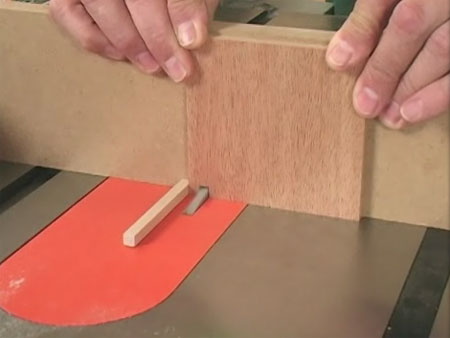

Ron for now though, before I get mine up here, this is what I use, very simple, this is shown on Wood Magazines Site. After you make a pass, you simply hook the new cut joint over the finger that is to the left of the blade in this image, then you make another pass, and so on till all the joints are cut.
You can see where this is going right? You don't even need instructions on how to make one, it's pretty straight forward. And you can see why the runout or play in your blade doesn't matter.
Here is their video too. In this video he is making the jig, cutting the notch for the finger to fit into, the finger is cut the same size as the box joints you want to make.
