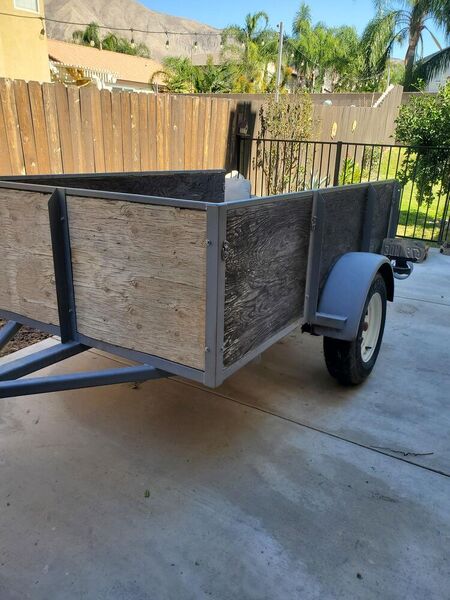

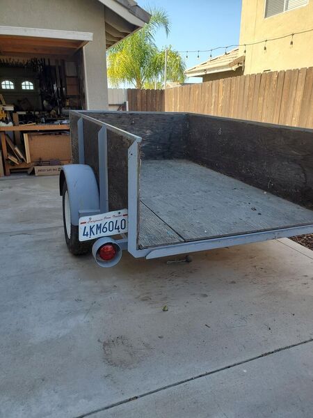

Here she is in the rough, it's been sitting a long time, I used it as lumber storage, till now. It has the original 5/8" CDX installed.

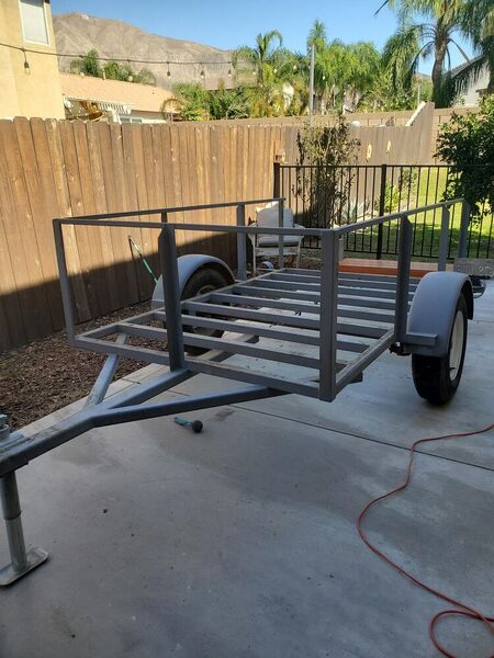

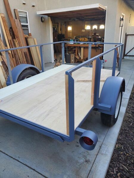

gages trailer (4).jpgI stripped it bare to the frame.
gages trailer (5).jpgBefore I started replacing the lumber, I checked the wiring, re-wrapped it, made sure the lights worked, and I knocked it down quickly with some sandpaper and rattle canned it primer gray just to give it a fresh look, and I have the first sheet of ply down, with it's accompanying 12" strip to make that 5' wide deck.
You can see the furring strips I cut to install under the rail inside so I can float the sides above the rail a foot taller. The OG trailer had the sides below the rails as you can see above, my modification will be a taller, and enclosed box.
gages trailer (6).jpgI rattle canned some truck bed black texture spray on the deck, that's why it's black in color now, I also painted the bottom of the plywood deck before I installed it, so it'd be road wet resistant on the underside.

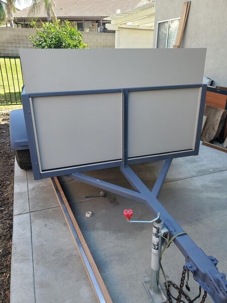

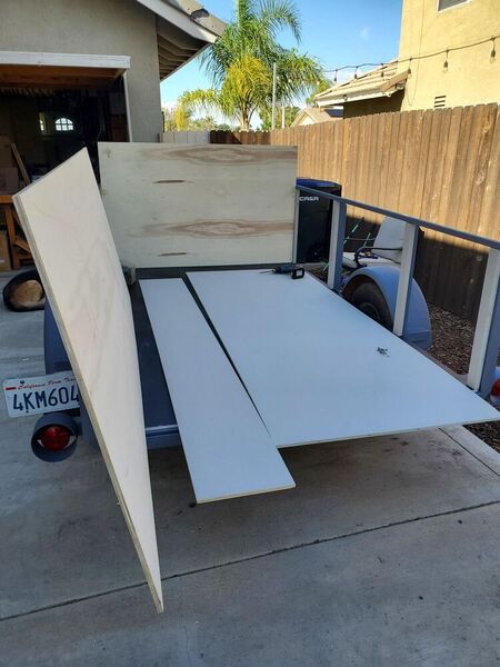

gages trailer (7).jpgFirst panel in place

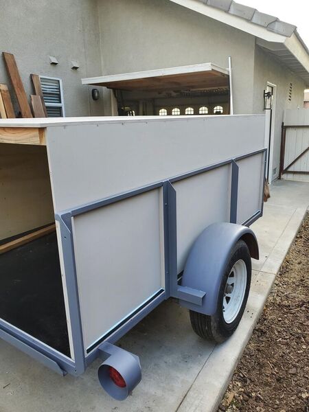

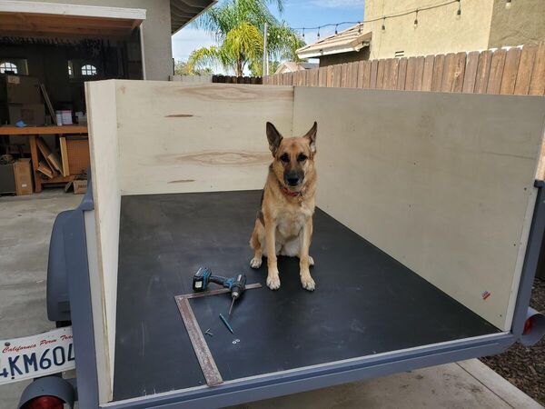

gages trailer (8).jpgSide panels installed, without my prompting, my doggy Lady jumped right in and had a seat, she wouldn't budge!

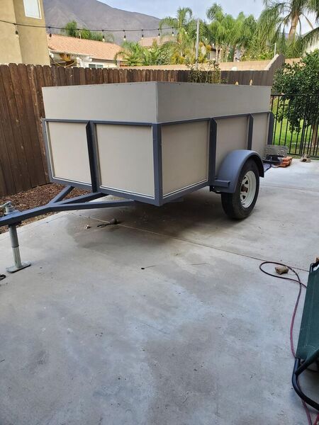

gages trailer (9).jpgAll sides installed

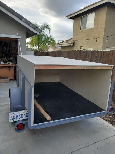

gages trailer (10).jpgRoof installed. I have 2x3's framing the perimeter of the roof on the inside and the roof is glued, screwed and tattooed in place, so hopefully it'll withstand 65 mph fwy speeds. I used exterior Liquid Nails, and screwed down every six inches. I used deck deck screws, drove them in flush, and I went over each screw head with Bondo and 3 coats of exterior paint for the roof.
gages trailer (11).jpgLooking good!
gages trailer (12).jpgI'll install 3/4" aluminum corner to the entire top perimeter as seen below.

Nice trailer...but really like that K9 helper in the one progress picture!
She watches my 6 Barb while I got my head down in the work, in our neighborhood, she earns her keep!
