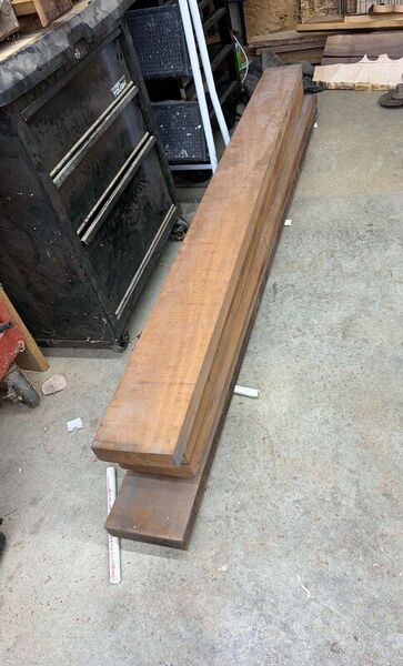

50 board feet of pattern grade Mahogany.
That's what I have in my shop just now. Have no idea how much this stuff would even cost. 7 boards about 7' long, 1.75" thick and about 7" wide. Beautiful stuff. I was contacted by a nephew who is the tooling engineer for a local forge shop. His shop wants to forge some retirement gift/promotional items and they want knobs made from this mahogany.

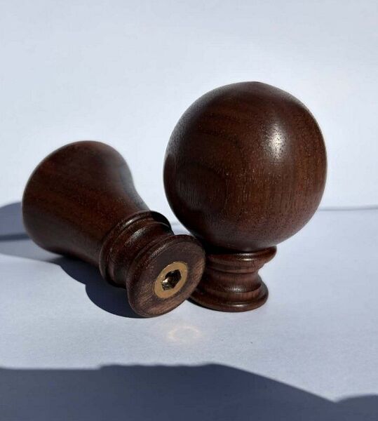

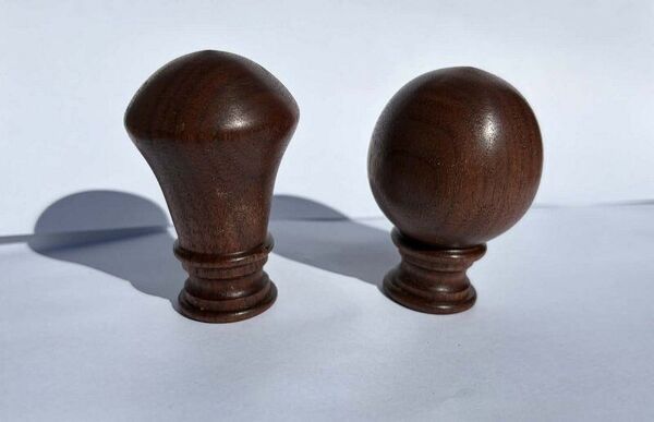

I had some concerns about the joint between the knob and forging so I suggested a detail to hide any discrepancies between the two and gave them another option for the knob shape and sent a picture. The shop thought the detail was a good idea but wanted to stay with the round knob. Oh yeah, they want 300 of them.

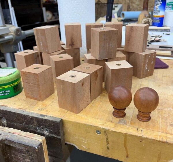

I decided to do them in sets of 25, they get a threaded insert and that makes them easy to mount for turning. I already know I need to get faster on them as it's about a 13 minute turn, hope to get that down closer to 10 minutes. I'm still finding my way with them so I'm hopeful for that. Here are the first couple and the prepped banks.
