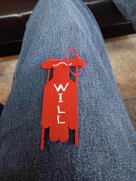

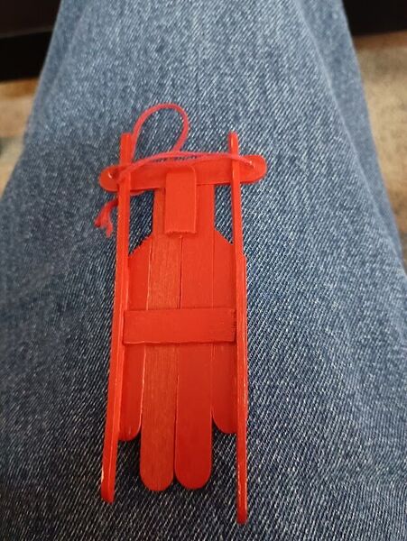

I am working on some projects where I need to rip craft (popsicle) sticks a little more than half down the middle. Once done, the cut edge needs to be fairly straight as it will be glued. I did some of these projects a dozen or so years ago, but I'm not sure how I did it. I am trying to find a safe way. My first thought (without thinking about it at 5 AM trying to get back to sleep) is to rip on a bandsaw (with a sliding table), then put a plane upside down in a vise and smooth the edge after cutting. My father made some of these decades ago, and the only power tool he had was a table saw and just a few hand tools. Though he had a lifelong friend and HS classmate who was a woodworker.

Well, I ran a trial and it seemed to work just fine. I taped together 6 sticks, set up a fence at the right distance, then ran the sticks halfway thru, stopped the saw, pulled them out, flipped, so the same side against the fence and cut the other half. No fingers were damaged in the process.
