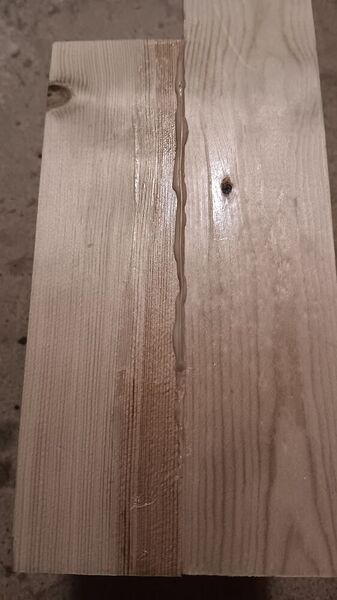

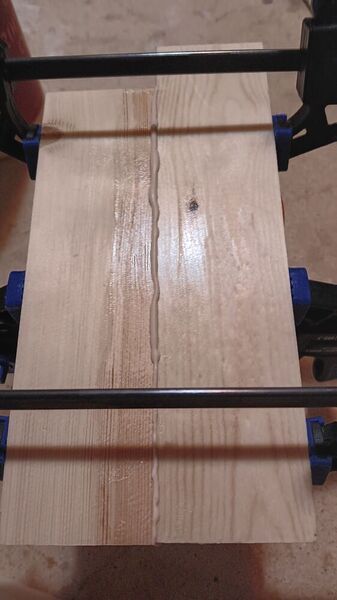

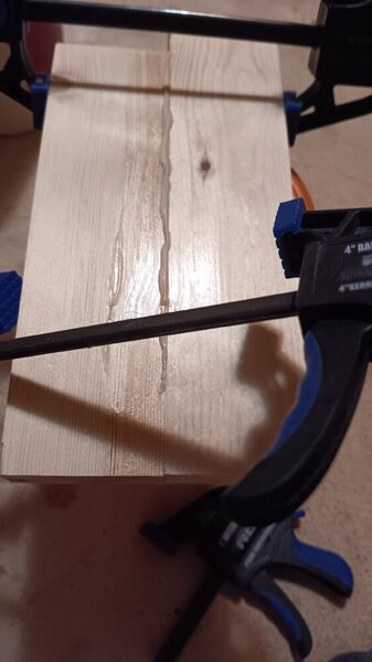

Then, per Fig 3, I mate the glued edges, do a pressure rub, and clamp. You'll note the squeeze out.
Fig 3
I leave it for 15 -20 minutes and then remove the clamps. See Fig 4. The glue will be jelly like. If it's semi hard you've left it too long.
Fig 4

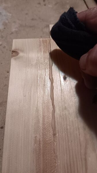

The wax (wood butter) in Fig 5 prevents the squeezed out glue from completely drying.
Fig 5

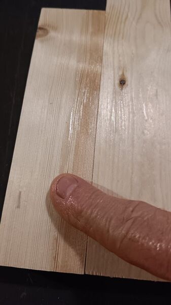

You simply wipe it off with a rag per Fig 6.
Fig 6

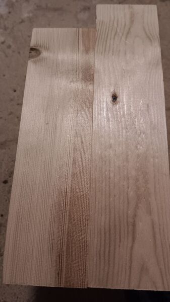

This is what you're left with per Fig 7.
The joint is already dry, but leave it overnight to fully cure.
Fig 7

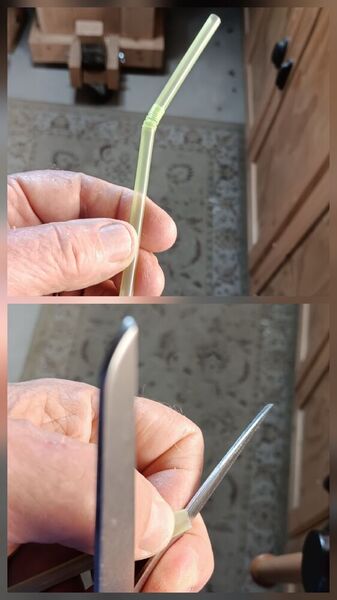

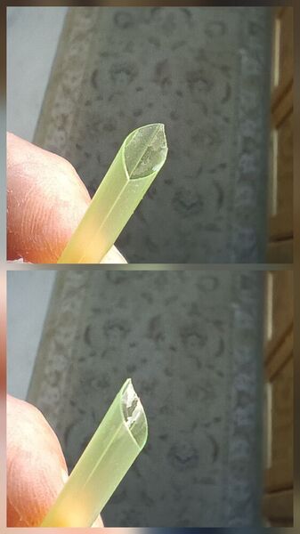

For squeeze out in corners I use a plastic straw. I simply snip one end off at about a 45° angle. See Fig 8.
Fig 8
Here's a closeup of what it looks like per Fig 9
Fig 9

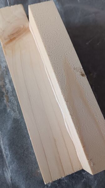

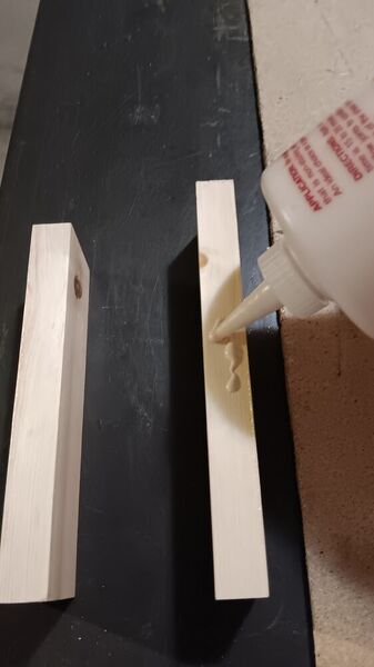

Here's a couple pieces of wood that I've applied glue to, pressure rubbed and then applied a couple clamps. See Fig 10. (Note the squeeze out)
Fig 10

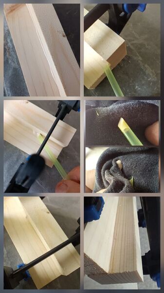

You want to collect the glue just after the squeeze out happens. Don't do it later.
Here's a step by step overview (Left to right, top to bottom) per Fig 11
Fig 11
