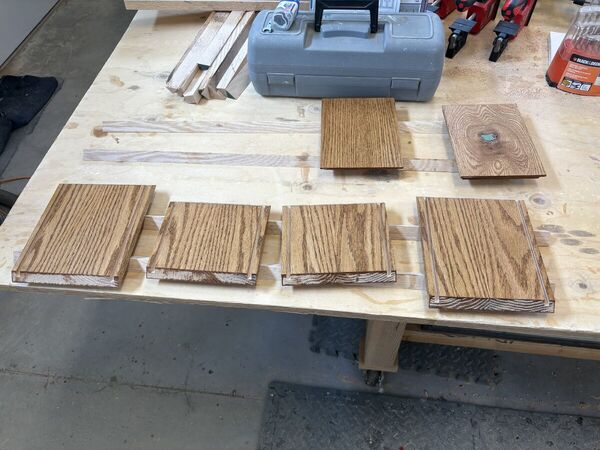

found a piece with a nice knot, filled it with turquoise dust and poly, that will be the top. red oak all around, will stain to match the table and benches i made for them. have a brass plaque on order that will go on the top too, just under the knot, with Milo's full name and a Latin cross on it..
got it all dry fit, need to final sand, stain, then glue up. then cut the top off and fit up the hinges and latch (brass). then poly.

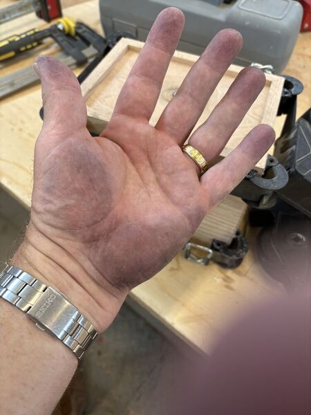

as many of you know, working with red oak will turn your hands black when your sweat interacts with the tannic acid in the oak. it'll wear off.
Very special project. Nice to use the same wood as the original table project.
I had never heard of the sweat reaction with the red oak. Very interesting.

I gotta admit, I wasn't aware of the Red Oak and skin either, but I can probably count the times I've worked with Red Oak on 4 fingers, and it's been awhile.

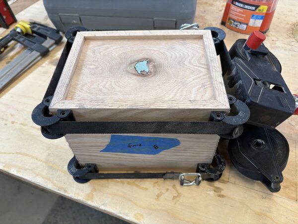

gluing up.....
I've seen the same sweat reaction with mesquite, though it did seem to vary a lot with individuals. I kind of wonder if the extent of it has something to do with iron levels? Or perhaps just the degree to which handling tools and machinery gets iron on your skin?

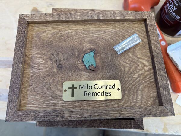

not much to show today, but got the top cut off, cut edges sanded and stained, hinges and latch fitted up (holes drilled for screws). poly tomorrow. 2 coats planned, then reassemble and attach name plate (on the way) and done.
Never heard of the red oak reaction with sweat before. I work red oak a lot and haven’t had that happen. It must be particular to the individual, like how some peoples skin will turn copper jewelry green.
nameplate arrived early, yay, and mom approves.

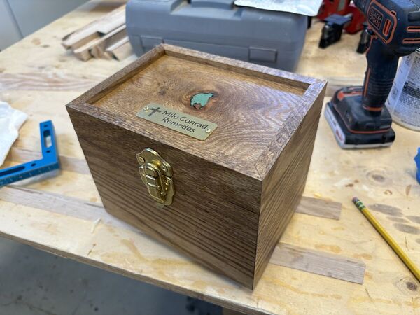

got the 2nd coat of poly on this am, let it cure, 3rd coat undecided, stay tuned.
done.
Awesome job, you should be proud. I’m sure they’ll cherish it.
